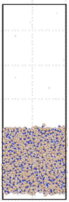

I am simulating the dynamic evolution of a slab under radiation using ReaxFF. I want to delete the gas-phase species such as NH3, H2 produced during the radiation. By using the fix reaxff/species command in LAMMPS, I can delete all of the NH3 and H2 molecules. Is there any way that I only delete the gas-phase species when they have moved into the upper region of the simulation box (above the slab)? Currently with the fix reaxff/species delete species.del specieslist 2 H2 NH3 command, I noticed many NH3 molecules are deleted when they are still inside the slab, which is not reasonable. Do I have to modify the source code to realize this function?

Thank you very much! I defined a dynamic group UPPER for atoms in the upper region of the simulation box, and applied fix UPPER reaxff/species delete specieslist 2 H2 NH3 command only on the UPPER group instead of all. Then only H2 and NH3 in the upper region are deleted. However, for species that across the boundary of the UPPER region, for example, 2 H atoms of one NH3 molecule are in the UPPER region while the remaining N and H are not in the UPPER region. We want to delete the entire NH3 molecule. However, I suppose the command will delete the 2 H atoms in the UPPER region because they may be recognized as a H2 molecule. To avoid this problem, LAMMPS needs to know the molecule id for each species. Do you have any suggestion to deal with the deletion of species across the region boundary?
