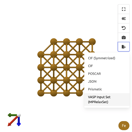

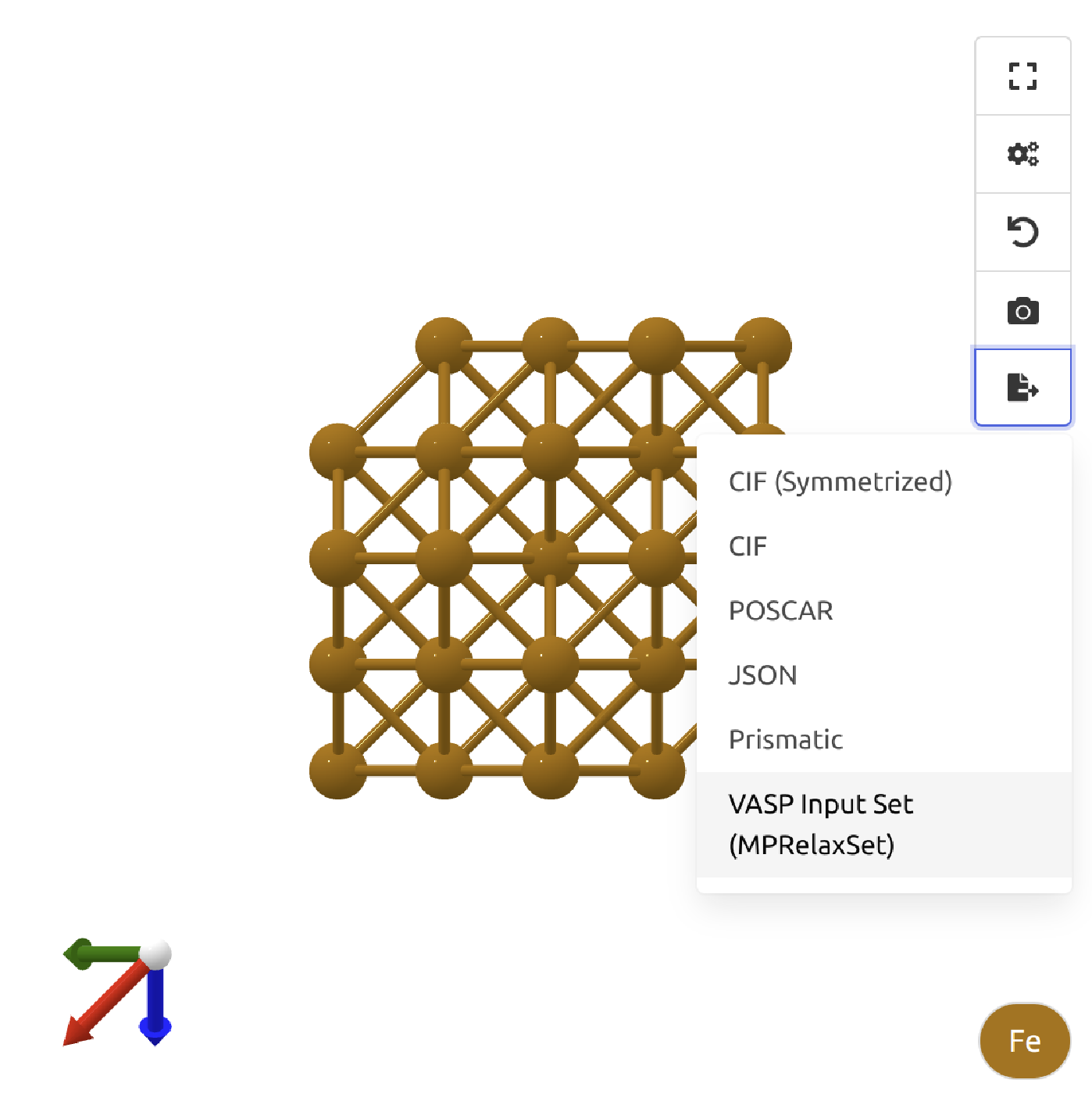

Hi, yes these files are still accessible through the web interface. On the interactive structure, there’s an “export as” button that allows you to download different files. To get the INCAR, download the VASP Input Set.

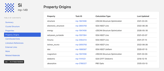

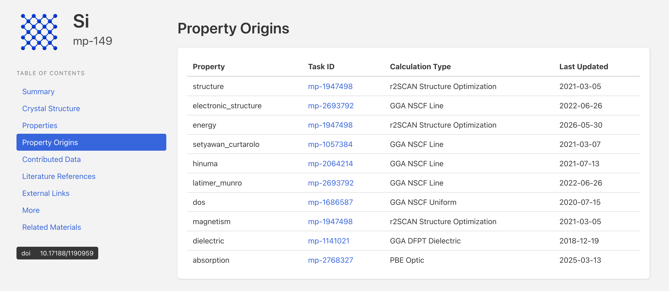

But I don’t have the python client mp_api yet. Can I see which tasks are used for the DOS and bandstructure calculations directly on the website?
Thank you!
Yes, we’ve recently added Property Origins to the website. See the attached image for mp-149.
Oh, I see it on the website.
