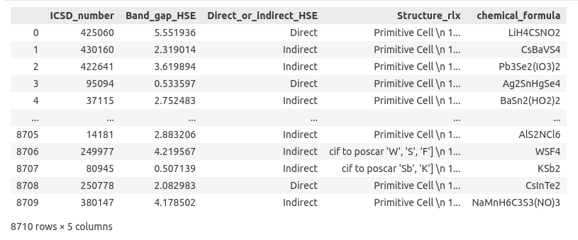

Hey Matminer! I have some cif files downloaded from the recent experiment, if I want to obtain the “structure” column as shown in the image below, could you tell me how to get this column of data? Thank you very much for your reply.

I want to do the inverse! I have a dataframe with a column containing structure features, These materials do not have any cife files, and I want to read this column with pymatgen directly by the IStructure function without creating cife files to use in ACSF function. The format of the structure is the same poscar but the number of lines is different.
