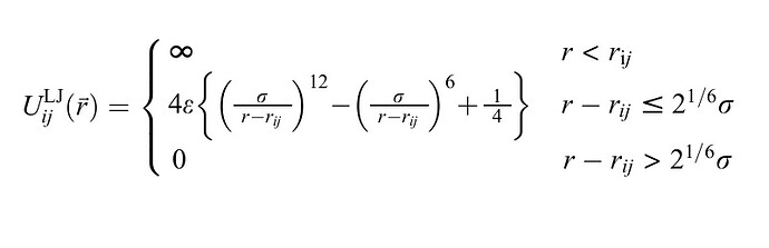

I am using lammps to calculate the coarse-grained polymer system via LJ nonbond potential table of my own. The function of the LJ bonbond potential is like this:
In the piecewise function, the first part from zero to rij is an infinite range. My question is whether the lammps could express the infinite energy in the nonbond potential table.
​this is not needed (and not meaningful). just define your tabulation
between a reasonable inner cutoff which is larger than your r_ij. due to
the shape of the potential, particles must never come close this inner
cutoff anyway.
... or you can just use the lj/expand pair style.
axel.​
