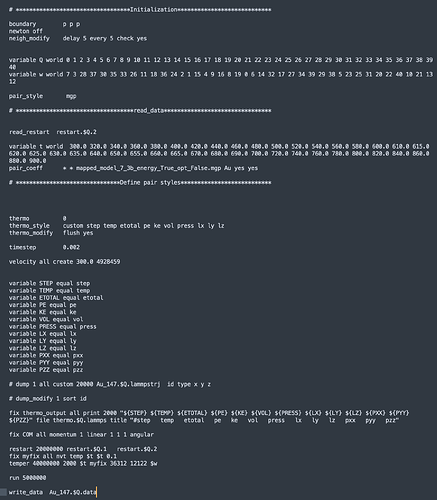

Hi Dr. Akohlmey, I’m so sorry for my confusing quoted input.

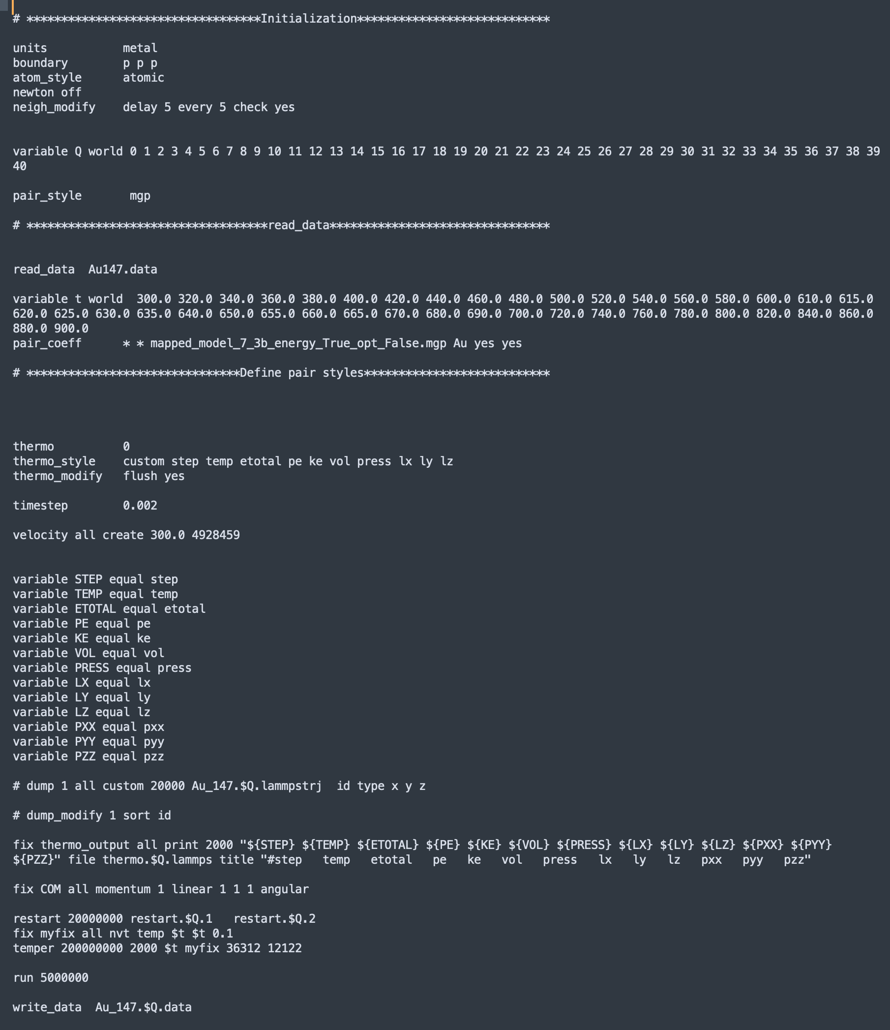

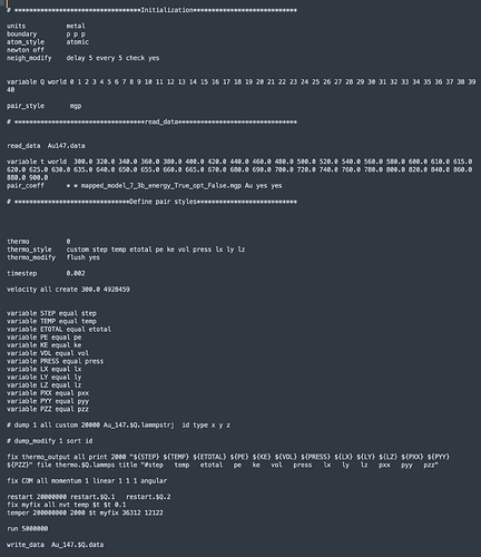

I’m trying to restart a parallel tempering simulation, and my input file of that parallel tempering is
From this, for each replica, I generate two restart files as restart.$Q.1 and restart.$Q.2.
Then to restart this simulation, I defined a new world variable t as variable w world 7 3 28 37 30 35 33 26 11 18 36 24 2 1 15 4 9 16 8 19 0 6 14 32 17 27 34 39 29 38 5 23 25 31 20 22 40 10 21 13 12 and the rest of my input file is:
Since there are two restart files, may I ask which restart file I should read? (restart. $Q.1 or restart.$Q.2?)

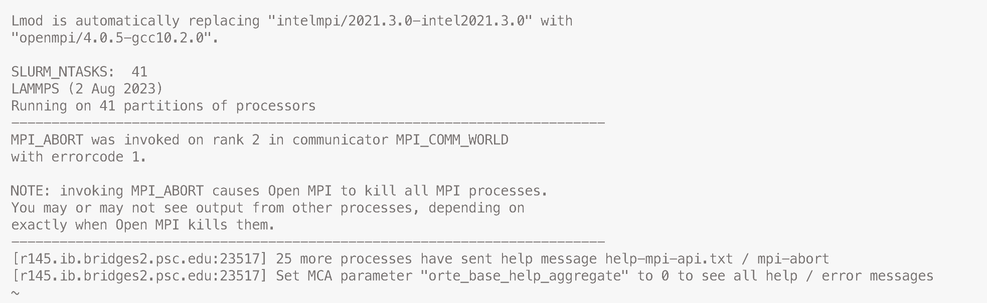

And my new restart file doesn’t work with this error:
Could you please help me resolve this issue? I searched this error ‘MPI_ABORT was invoked on rank 2 in communicator MPI_COMM_WORLD with errorcode 1.’ and I don’t know how to fix it.

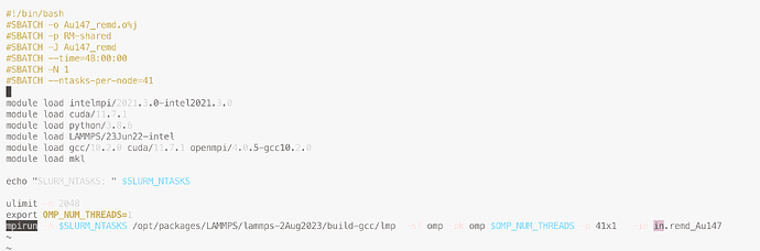

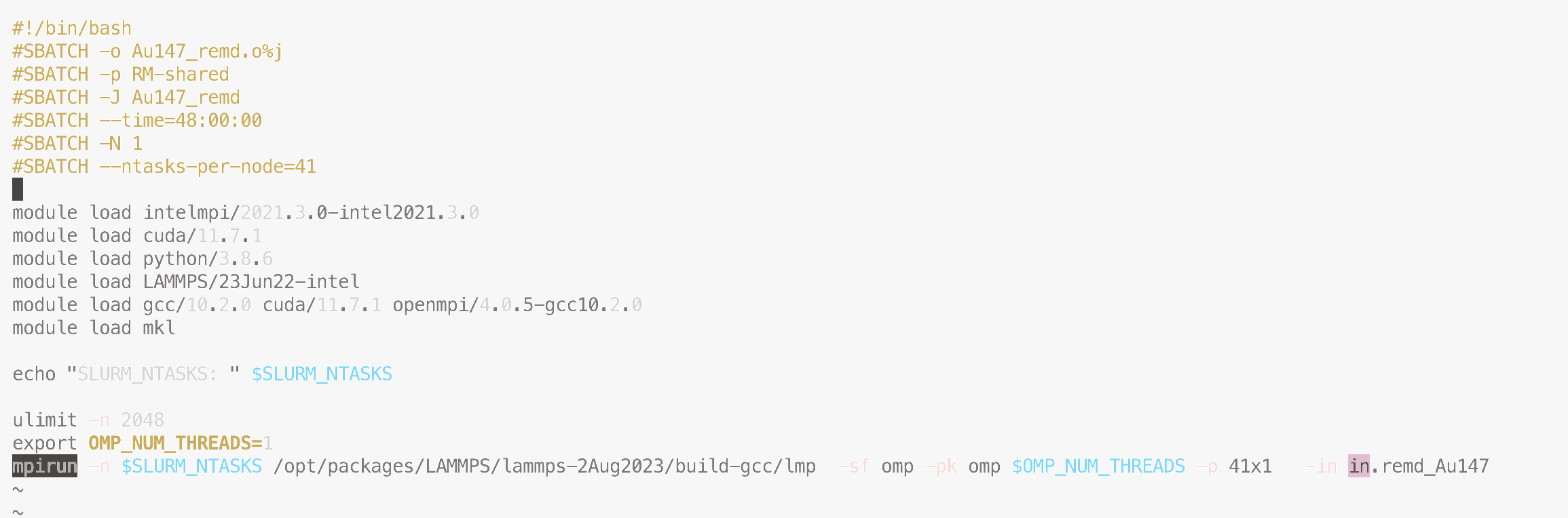

for potential consideration, In the new restart simulation, I offered those restart.$Q.2 files, force field, input file, and my shell file, here is my shell file and it worked well with the previous normal parallel tempering simulation:
Thanks and I appreciate your response.

This is not the error message that matters as this is only for the “universe” MPI rank. The error happens within the individual partitions and thus you need to look at their log or screen files.
If those are empty, consider (for debugging purposes) to turn off I/O buffering by adding the -nb command line flag.
Hi Dr. Akohlmey, thanks for your kind reply. I will read the guidelines and follow the quote rule. And I have solved this issue. I should define the pair style after the line of reading restart files, as the mgp pair-style seems not to be stored in restart files.
