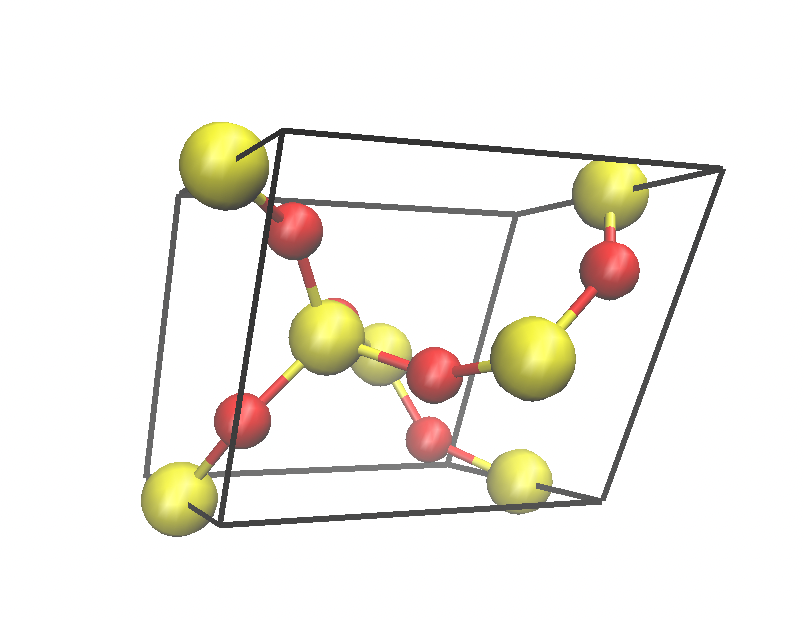

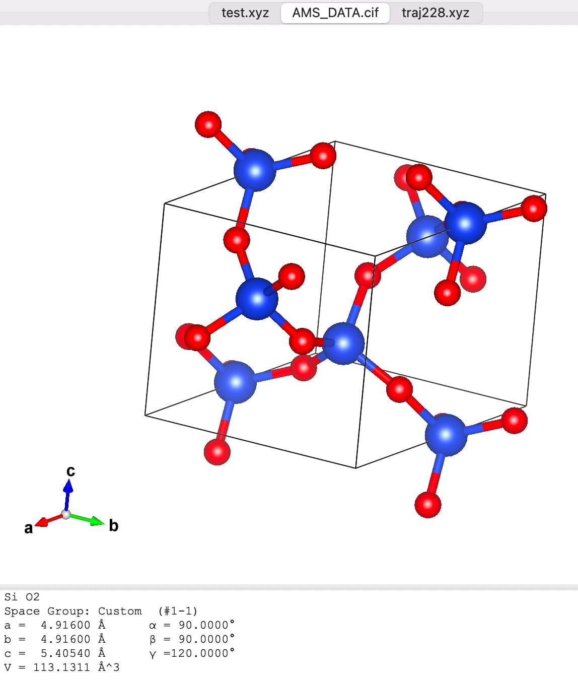

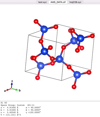

I downloaded the *.cif file and opened it with VMD. I found that the structure looked terrible (Fig. 1). Then I opened *.cif file with VAST (see Figure 2). I deleted the atoms outside the cell box and finally got the structure in Figure 3. Then I used Matlab to write the structure in xyz format as a data file. Then I used replicate to get the bigger structures.

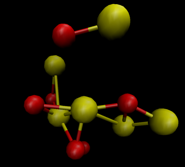

I checked the structure after MD simulation with reaxff. It looks very terrible. Check the out file, I found that when I used replicate, the number of atoms in the system increased, and the tilt also increased exponentially, making the structure of MD simulation very strange.
