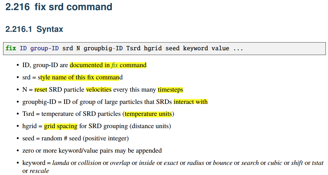

How to set rotation angle α in SRD (Stochastic rotation dynamics) of LAMMPS?

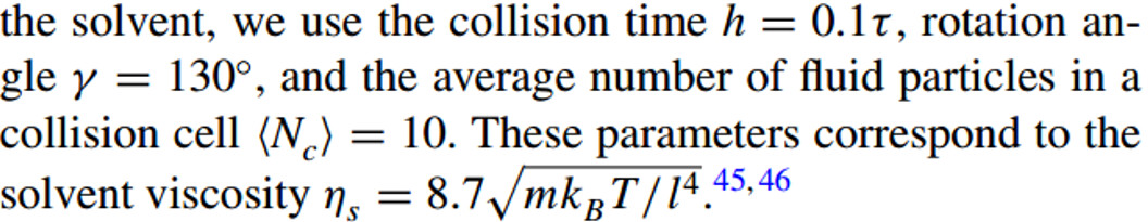

Using SRD to simulate hydrodynamic interactions requires setting the rotation angle α.
But I couldn’t find the relevant option for rotation angle in the fix srd command in LAMMPS manual. I would like to inquire about how to change the rotation angle setting. Thanks
