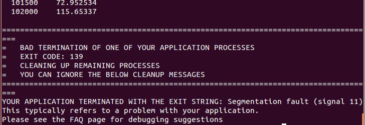

After searching the mail list, I find that someone simulate the TIP5P water model by set the mass of the dummy site as 0.001% of hydrogen’s mass. I don’t know whether it is right. However, when I try to use this method, my MD simulation will go wrong after some steps (error: ).
How can I simulate the TIP5P water model in LAMMPS? Would you please give me some suggestions?

Thanks for your kind reply. I want to simulate the condensation of 120 tip5p water molecules on a particle composed of acetic acid molecules. According to the suggestion in the mail list, I set the the mass of the dummy site to 1.0e-6 and use the “fix rigid/nvt” for the tip5p water molecules.
However, my MD simulation will go wrong after some steps.
All of the lammps files are in the attachment. Could you please tell me how to correct my lammps imput file?
