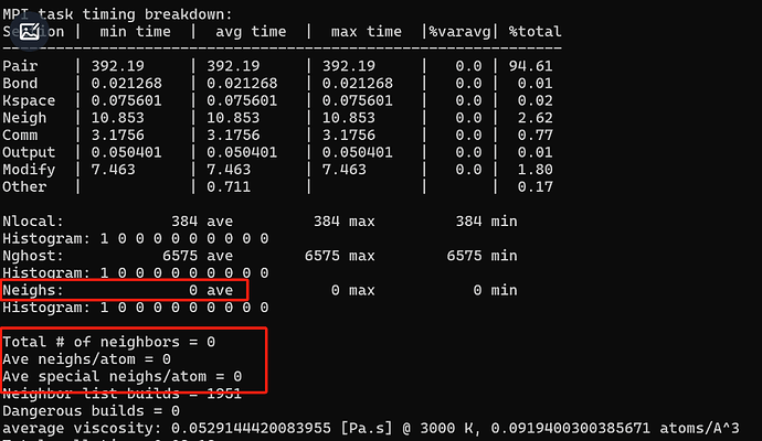

I am using LAMMPS to calculate viscosity and can obtain the result, but I found that neights is 0 in the calculation process file. How can I modify this?Below are part of my codes:

and this is part of my log file and i wonder it is right for me to just check the last MPI task timing breakdown?

What is your concern here? Did LAMMPS not compute what you asked it to do?
Please note the neighborlist statistics is a pure diagnostic and with complex hybrid pair styles, LAMMPS may not find a representative neighbor list for the system. Even if it does, the results are for that one neighbor list only and not the remaining lists for other sub-styles.

Thank you for your reply. LAMMPS has provided results for the code I input, but I noticed that the boxed-out part shows 0, which is different from my previous simulations, so I had some doubts. Based on your response, can I understand that if LAMMPS can produce results, in the case where the pair_style is set to hybrid/overlay, there is no need to focus on the “neighs”?
I’ve already answered this. Let me quote it again:
In other words, the output you are looking is only meaningful when you have a single neighbor list covering all atoms. But with hybrid pair styles, this is usually not the case. If LAMMPS cannot find a suitable neighbor list, it will not output the neighbor list statistics.
If you worry about correctness of your results, you have to look at the forces though.
