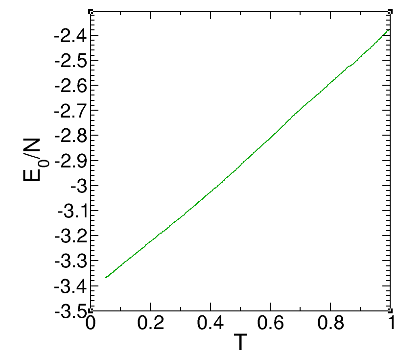

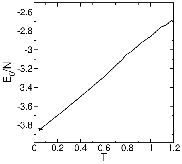

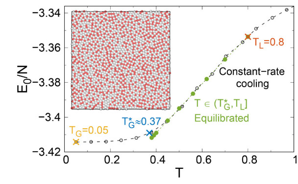

However, I found that the Potential energy per particle in the cooling process is inconsistent with the paper:
Did I ignore some commands in the process of writing the IN script, which caused the energy to deviate?I would be grateful if you could answer this question
The quoted paper says “shitfted force LJ” potential, but you are using a plain LJ with cutoff only.

However, after recalculating the calculation, I found that the potential energy per particle in the inherent structure still could not correspond to the text. Theoretically, the curve should be flat during the cooling process, but it did not. Could you please take a look at my script again to see if there are any mistakes I made?Thank you very much.

As a quick observation, in the paper screenshot, the average potential energy ranges between -3.34 and -3.42. In your results the range is much larger, which would seem far more typical of a less dense system. I can’t see any obvious issue with your input, but you should visualise your trajectories and see whether the particle density created is correct.
