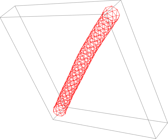

I was trying to do that. I got the atoms positions of the equiblirated structure, but its a little bended. I need to add the cross bonds as well which are like this (in the initial structure I had 2 types of bonds, the ones you see in the previous picture and the following bonds):
Since the equlibrated structure is bended a little bit, I find it difficult to add the cross bonds . I was looking for a possible easier way to do this.

This statement doesn’t quite make sense to me since in LAMMPS (and molecular dynamics in general) you can just add a bond by specifying which two atoms to join. You don’t need their positions. Look at the Bonds section of your data file and you’ll see it’s a list of “bond ID, bond type, bond atom 1, bond atom 2” (and maybe other numbers I can’t remember, but definitely not coordinates).
So it shouldn’t matter that there’s a little wiggle in the nanotube.
True, I was mistakenly outputting the positions only .
