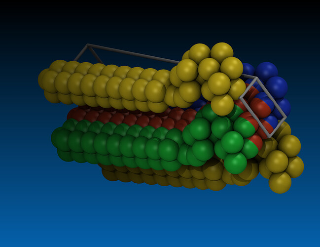

- The box dimensions are bogus and thus periodic images overlap (in x) or have a gap (in y) or the gap is (in z) not present (but it should be big). See the attached visualization where the red atoms are the original box and the colored ones periodic replica
- There are bad settings: timestep is too large, bogus neighborlist settings, kspace force error far too large
- There should be some kind of box relaxation in x and y. But then again, the proper box dimensions in x and y should be known beforehand and the potential used for the material is not very accurate and those atoms are kept immobile anyway.
- There seem to be incorrect assignments of angles or dihedrals
This whole input looks like it was done by somebody with limited understanding and no checking of whether inputs are correct or meaningful.
As mentioned before, this is not something that can be rectified in a forum with a few “do this, not that” kind of statements, but requires proper tutoring by an experienced practitioner in MD simulations that will lead to a proper understanding of the physics of the model and methods used to represent that physics.
