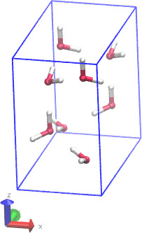

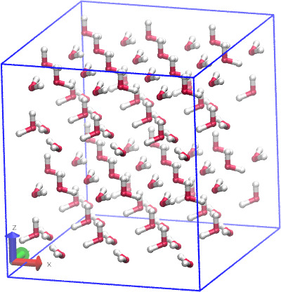

Dear Ali
I prepared an example, how to build an ice-crystal using moltemplate
using the coordinates I sent you earlier. ("spce_ice_rect8.lt", shown
in "ice_rect8_unitcell.jpg"). When you run:
moltemplate.sh system.lt
It will build the system shown in "ice_rect8_crystal_3x2x2.jpg" (see attached).
This ice unit cell ("spce_ice_rect8.lt", and the larger ice unit
cells) will be included with future versions of moltemplate. (It's
not hard to make more complex structures, combining ice with other
impurities, or creating a boundary between ice and water, or some
other solvent.)
