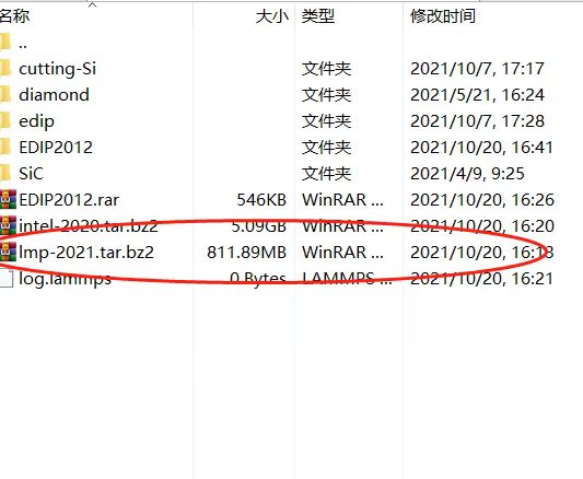

Dear sir, i am so sorry. This is the first time I’ve asked a question here. As for as I know, the software I’m using is the 2021 version. I use the school’s server to run the program. But don’t know exactly what the platform is.
Attached is the software installation package used by our server.

Your platform appears to be some kind of MS Windows, but your installation packages do not look like they are official packages. So there you are on your own. You can find more recent versions of LAMMPS for Windows here: LAMMPS Windows Installer Repository
If you insist on running an older version of LAMMPS, you also must consult the manual that corresponds to your specific version of LAMMPS. The online manual always represents the latest release.
