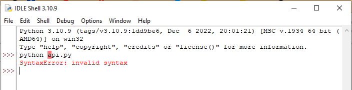

b) Tried to execute it using python api.py but shows attached error.

Hi @Murphy_Chan,
it looks like you’re trying to run the python command from within a python shell/interpreter. Try to run it from the command line (bash shell) directly.
