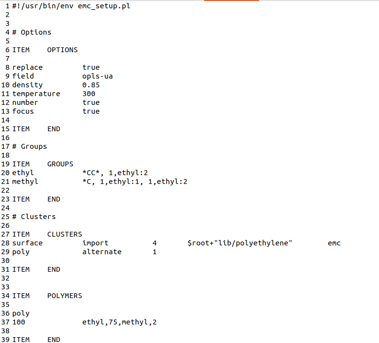

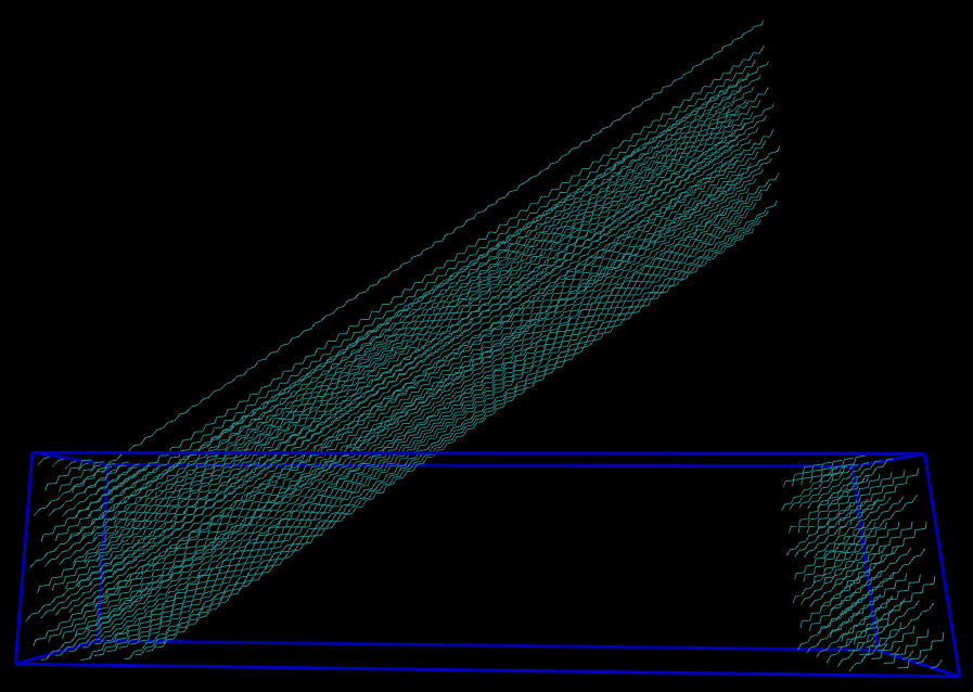

Regarding your second post
You trying to import a polyethylene crystal structure, which already contains group definitions for the methyl group, which is using EMC not as intended. You do not have to import the polyethylene crystal structure, if you intend to only build amorphous polyethylene. I would suggest using
examples/build/polymer/polyethylene/build.emc
if you are interested in generating semicrystalline polyethylene.
