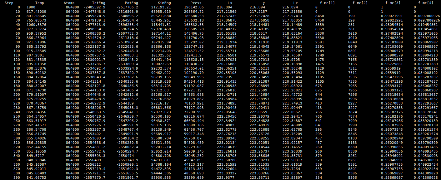

When performing MD/VCSGC simulations, as described in the Scalable parallel Monte Carlo algorithm for atomistic simulations of precipitation in alloys(2012) , when k(kappa) is set to a very small value, the unreasonable chemical potential difference(deltamu) leads to large concentration fluctuations. However, in the simulation of the CuCr system, in order to select a suitable chemical potential difference, I set a value of kappa=1 and changed deltamu for the calculation, and when deltamu<0, the number of exchange successes(f_mc[1]) and failures(f_mc[2]) remained unchanged no matter what the deltamu was,as shown in Figures.

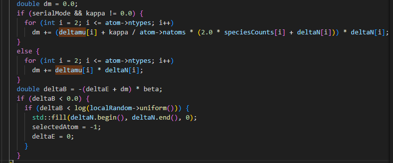

According to the Metropolis acceptance criterion provided by fix_sgcmc.cpp in the source code, deltaB = -(deltaE + dm) * beta, theoretically the smaller deltamu is, the higher the acceptance probability is, and the higher the number of acceptances. In addition, according to the energy difference calculation method provided by Database-driven semigrand canonical Monte Carlo method: application to segregation isotherm on defects in alloys, we calculate ideltaE<0 of CuCr system, So with the setting deltamu<0, the theoretical probability of reception is 1, the number of failures is 0. So, I would like to know why this simulation result occurs.
