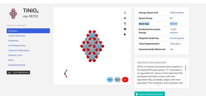

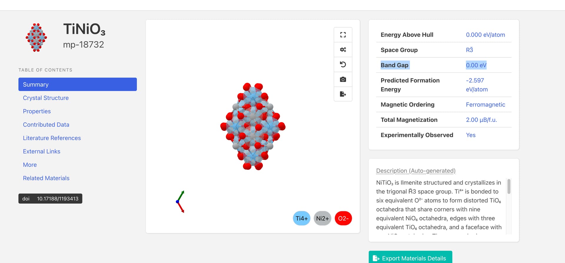

Hi @ZhouGD,
where are you seeing a 2.724 eV bandgap on the website?

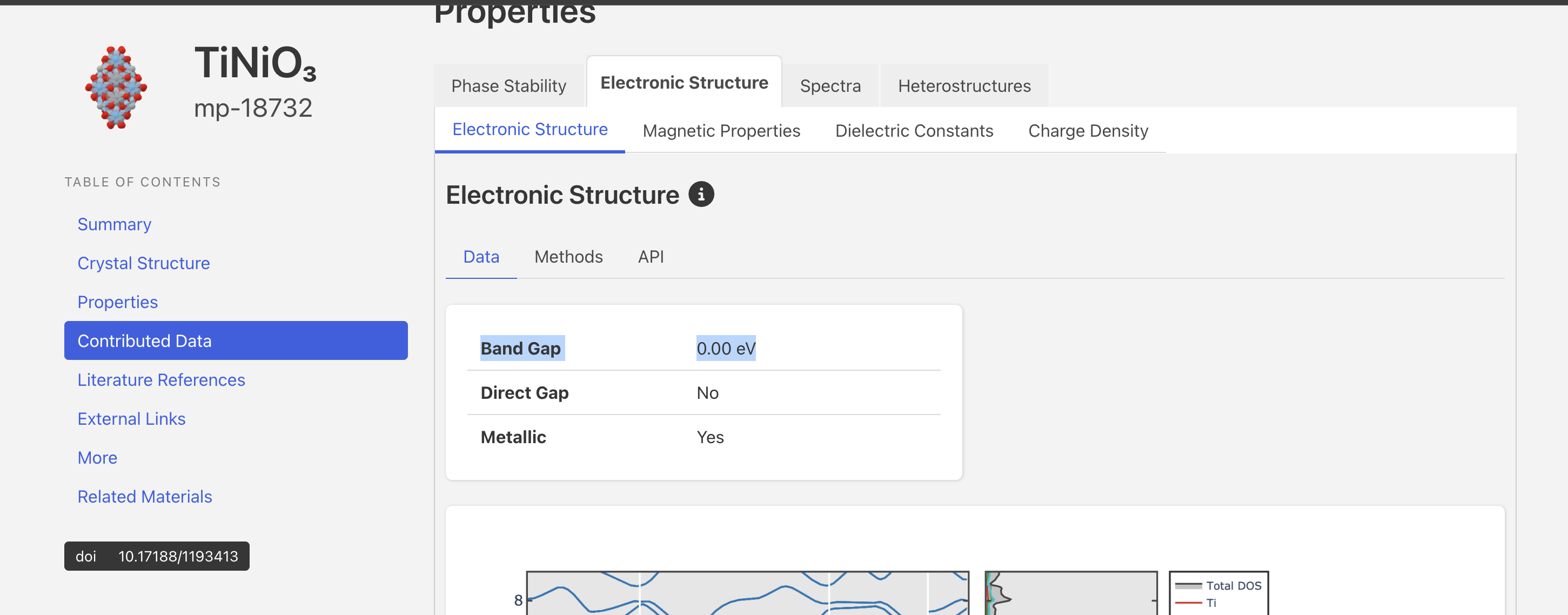

Hey @ZhouGD the 2.7 eV bandgap is reported on the legacy website, which is no longer updated and will be taken offline this fall.
As @tsmathis showed you, the current website, has been updated with newer calculations. The current next-gen website uses the same data as the API, hence the 0 eV bandgap in the newer data
