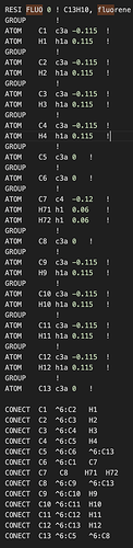

I am using EMC (Enhanced Monte Carlo) with the OPLS-AA/2024 force field and am attempting to incorporate fluorene (C13H10, SMILES: c1ccc2c3ccccc3Cc2c1) as a building block.
Here is a summary of what I have done so far:
  1. In opls-aa.define, I added a RESI FLUO entry.
  2. In opls-aa.top, I added the following atom typing rules:
    377 c3a C FLUO - 0 ^6c(^6:c)(^6:c)(^6:c)
    378 h1a H FLUO - 0 H(^4c)

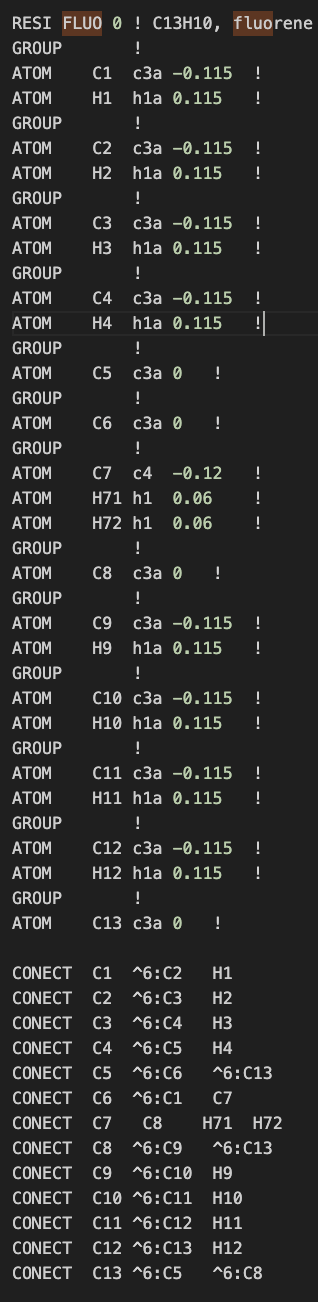

EMC interprets force fields either in a strict or less strict way. Number of ring members in rules are ignored in the latter, while number of ring members are considered in the former case. The number of ring members are indicated by adding a carrot to a rule, as you pointed out correctly. E.g. ^6c indicates an aromatic carbon being part of a 6-membered ring.
Coming back to fluorene:
The above structure consists out of two aromatic six membered rings and one mixed five membered ring. EMC’s interpretation of these rings can be determined by using -field_debug=reduced to obtain considered rules, which shows that carbons shared between five and six membered rings are identified as part of the smaller of the two rings. Furthermore, OPLS partial charges are different for SP3 carbons connected to aromatic rings when compared to your suggestion, as can be deduced from entries 148 and 149 in $EMC_ROOT/field/opls/2024/src/oplsaa.par,
148 06 CT   -0.065     3.500     0.066     all-atom C: CH3, toluene
149 06 CT   -0.005     3.500     0.066     all-atom C: CH2, ethyl benzene
where the fourth column represents partial charge. Bearing the above in mind, your entry would need to be altered into
RESI	FLUO	0		! C13H10, fluorene
GROUP					!
ATOM	C1	c3a	-0.115	!          H4          H12
ATOM	H1	h1a	0.115	!          |           |
GROUP					!          C4          C12
ATOM	C2	c3a	-0.115	!         /  \\       /  \\
ATOM	H2	h1a	0.115	!   H3--C3    C5----C13   C11--H11
GROUP					!     	||    |     ||    |
ATOM	C3	c3a	-0.115	!   H2--C2    C6    C8    C10--H10
ATOM	H3	h1a	0.115	!         \  // \  /  \  //
GROUP					!          C1    C7    C9
ATOM	C4	c3a	-0.115	!          |    /  \   |
ATOM	H4	h1a	0.115	!          H1 H81  H82 H9
GROUP					!
ATOM	C5	c3a	0		!
GROUP					!
ATOM	C6	c3a	-0.115	!
ATOM	C7	c4	0.11	!
ATOM	H71	h1	0.06	!
ATOM	H72	h1	0.06	!
ATOM	C8	c3a	-0.115	!
GROUP					!
ATOM	C9	c3a	-0.115	!
ATOM	H9	h1a	0.115	!
GROUP					!
ATOM	C10	c3a	-0.115	!
ATOM	H10	h1a	0.115	!
GROUP					!
ATOM	C11	c3a	-0.115	!
ATOM	H11	h1a	0.115	!
GROUP					!
ATOM	C12	c3a	-0.115	!
ATOM	H12	h1a	0.115	!
GROUP					!
ATOM	C13	c3a	0		!
CONECT	C1	^6:C2	H1
CONECT	C2	^6:C3	H2
CONECT	C3	^6:C4	H3
CONECT	C4	^5:C5	H4
CONECT	C5	^5:C6
CONECT	C6	^5:C1	^5C7
CONECT	C7	^5C8	H71	H72
CONECT	C8	^6:C9
CONECT	C9	^6:C10	H9
CONECT	C10	^6:C11	H10
CONECT	C11	^6:C12	H11
CONECT	C12	^5:C13	H12
CONECT	C13	^5:C5	^5:C8
