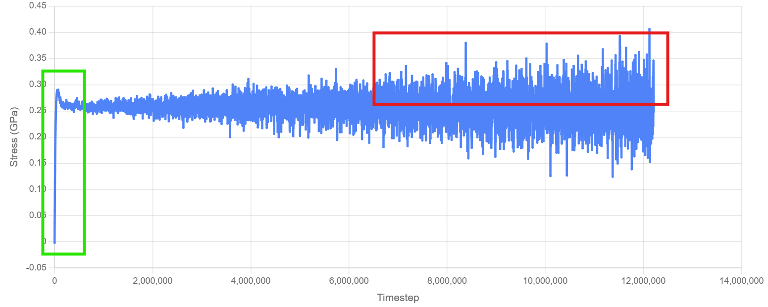

I am currently using LAMMPS (version 8 Feb 2023) to perform shear deformation simulations on an amorphous system. In my setup, the simulation box is sheared up to 61 times its initial length. I am using the NPT ensemble along with shear deformation at a strain rate of 1e10/s, with the following commands:
fix npt all npt temp 77 77 100 iso 1 1 1000
fix deform all deform 1 yz final ${final_strain} remap x flip yes
Here, ${final_strain} is set to 61 times the initial length of the simulation cell.
While the density of the system remains steady, I observe a significant increase in the amplitude of stress fluctuations (highlighted in the red rectangle). This issue does not appear in the early stages of the simulation (green rectangle).
I would appreciate any insights into why these increasing stress fluctuations are occurring during the later part of the shear process.
To investigate this further, I tried the following:
  1. I restarted the simulation from a point of high fluctuation using a restart file. Initially, the amplitude of the stress fluctuations returns to normal, but it builds up again after some time.
  2. I took dump trajectories (containing only xyz values) from the fluctuating region and used the ā€œrerun commandā€ on them using LAMMPS. The increase in stress fluctuation amplitude persisted, suggesting that the phenomenon is already imprinted in the trajectory data itself.
Arafat

Thank you so much for your reply. As noted earlier, I’m running a shear-deformation simulation on an amorphous system contained in a triclinic box with periodic boundaries in all directions. The simulation uses real units with a 5 fs timestep. Please let me know if you need any further details about the setup.
To impose a shear rate of 1 Ɨ 10¹⁰ s⁻¹, I first calculated ${final_strain} and then set the total number of timesteps accordingly. The simulation employs two fixes simultaneously:
The NPT fix keeps the pressure at 1 atm, after which the fix deform command shears the system along the yz plane.
In the stress plot I shared earlier, the y-axis shows P_yz (pressure component in yz), while the x-axis represents the timestep.
I’m running these calculations on our university’s HPC cluster, which is why I’m using an older LAMMPS version.
AA

I’m simulating an amorphous glass with a coarse-grained water model and intend to shear the simulation box until it is 61 Ɨ its original length.
The reason is that the system’s density changes as it deforms, so a fixed-volume approach may not capture that behavior.
Would combining fix nvt/sllod with fix deform/pressure let me maintain the target pressure without artificially locking the volume? I’m not sure whether that setup can satisfy both requirements.

As @Germain already stated, It is essentially impossible to make an accurate assessment of the situation without being involved in the research yourself. For sure, this is a problem not caused by LAMMPS directly, but more likely through the model and methods that are being implemented (and thus would likely happen the same way with other MD codes). Thus, I can only speculate. Two things would come to my mind, a) the unusual geometry and unexpected finite size effect due to the extreme shearing; and b) a bad choice of Nose-Hoover damping parameters for the barostat: you may have chosen a parameter that is close to resonant with the fictitious dynamics of the Nose-Hoover chain.
You should not be using a barostat with such a tricky system setup unless you know for sure that you expect your real-life system to respond to pressure changes on picosecond timescales. The more things you add to a non-equilibrium simulation, the more likely it will be that you mis-specify something or have some components interact poorly.
I notice you did not use SLLOD – you should. As the box shears particles will pick up some amount of flow velocity which must be accounted for during thermostatting (otherwise, if this velocity is counted as thermal energy, the particles will be overcooled).
As far as I know, SLLOD equations of motion assume homogeneous planar shear flow. I don’t think this will be the case of sheared glass system even containing water. But this is just a guess given the few details we have on the simulated system and the simulation procedure.
