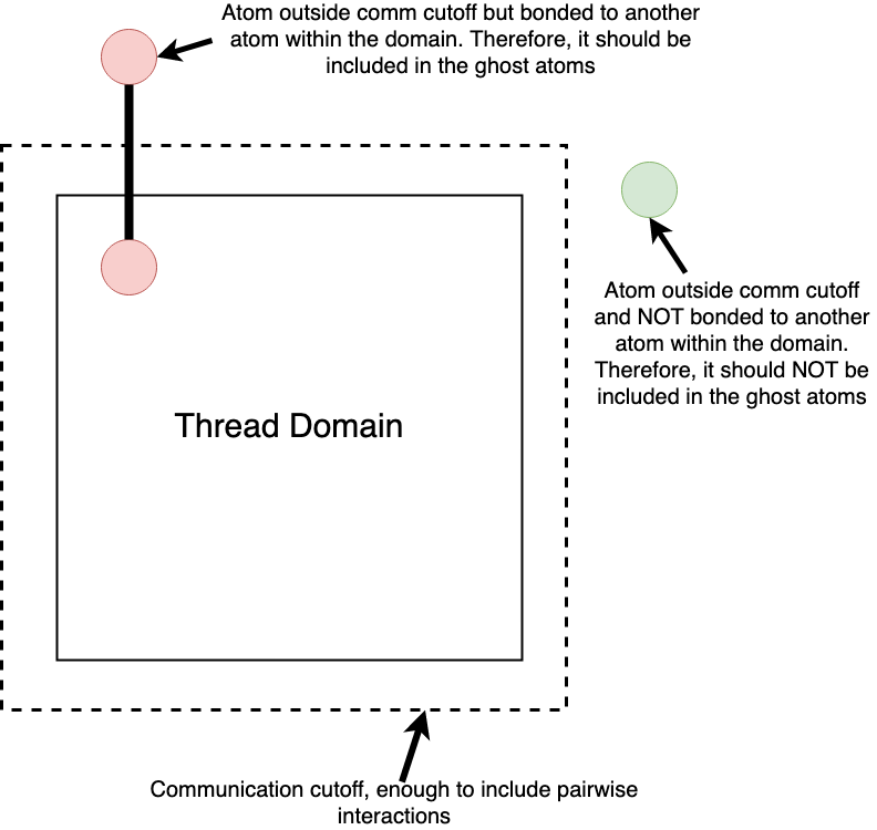

I am dealing with a particular case where the bonds between atoms are generally much longer than the pairwise interaction cutoff. As a result, I have to significantly increase the communication cutoff in order to take into account these long range bonded interactions. Of course, this increases computational costs, as much more ghost atoms are included per thread. However, most of these ghost atoms are totally useless, since they can only interact with the domain’s “true” atoms only through short-range pairwise interactions.

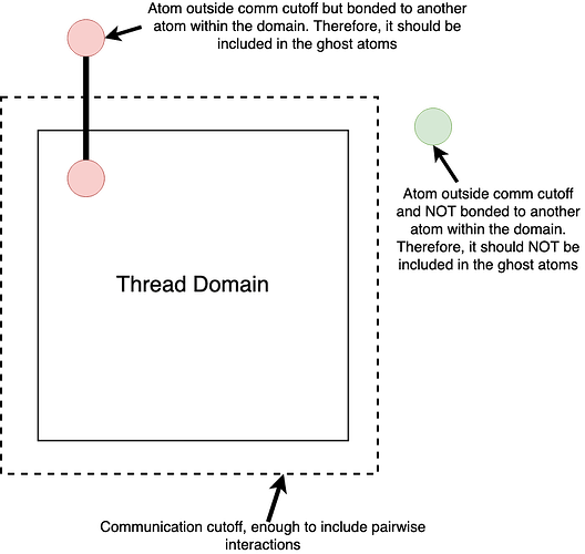

Given the above, I am basically trying to find a way to draw just the ghost atoms that interact through bonds with the domain atoms. I have included an image that may help a bit in explaining what I am trying to do:
Do you think that there may be a way to implement something like that in LAMMPS? As fas as I have understood from the documentation, there is no way to selectively create ghost atoms after a certain range (maybe it is possible through creating groups? Still, I cannot use this approach in my case because it would require creating more groups than the upper limit allowed by LAMMPS)
That was my first thought as well. The problem is that there is only one atom type in my case, i.e. all atoms have the same pairwise and bond interactions. On the image of my original post one should imagine that the green particle is also bonded to other particles, its just that those other particles do not belong to the domain in question. To put it another way, I want to set a different communication cutoff regarding the bonded interactions, not the atoms per se.

Then you are out of luck. If all atoms are bonded and bonded with the same bond type, then you must include all in the communication cutoff. If you have the same interaction parameters but different bonded/non-bonded status, you can just use multiple atom types with the same parameters.
Beyond that, it may be possible but will require some effort programming a new multi communication setting. But before that, we first need to see an example that can be used to quantify how much of a benefit there will be. It may not be worth the effort.
It is even more restrictive. You not only want to restrict to bonded atoms, but to bonded atoms where the bond straddle the subdomain boundary.
There is no ghost atom communication between threads, only between MPI ranks.
