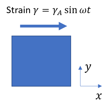

I intend to apply a sinusoidal deformation gamma_a * sin(omega * t) to the system, as shown in the figure below.
wiggle

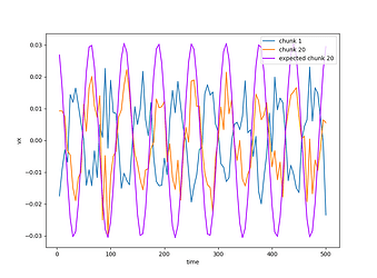

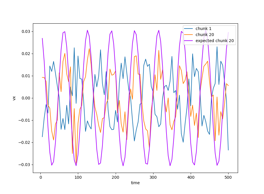

I utilized the fix deform wiggle ... remap v to induce deformation to the box. To apply this deformation to particles, I employed the fix nvt/sllod command.
Next, the box is divided into 20 equal parts along the y direction, and the average x-direction velocities of particles in each part are calculated.
I expected the average x-direction velocity of particles at position y to be y * gamma_a * omega * cos(omega * t), with the maximum velocity at the top of the box (the twentieth part) and an average velocity of 0 at the bottom, with the same phase.
However, I observed a phase difference of pi, resulting in velocities being opposite to expectations. The velocity at the top of the box (the twentieth part) is 0.5 * y_max * gamma_a * omega * cos(omega * t) instead of y_max * gamma_a * omega * cos(omega * t).
This means that the x-direction velocity for the tenth part of the box is closer to 0.

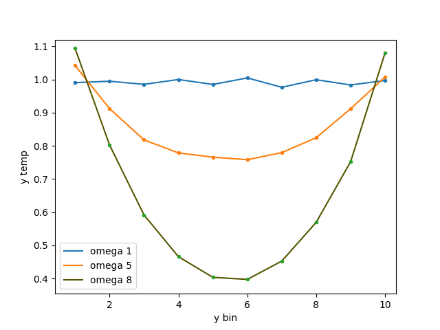

Thank you for your reply. Following your suggestion, I used the following command to divide the system into 10 segments along the y direction and calculated the temperature of each segment after removing the translational velocity using compute temp/profile.
compute unbiased_temp all temp/profile 1 0 0 y 10 out bin
fix output_temp all ave/time 100 10 1000 c_unbiased_temp[*] mode vector file unbiased_temp_$(v_omega).txt
I noticed that when omega is small, the temperature distribution along the y-direction is near the set value of 1.0. However, as omega increases, it deviates significantly from 1.0. The deviation is larger near the center of the box.
ytemp
I believe that the small deviation of the temperature distribution from 1.0 when omega is small is not necessarily an indication of the correct application of the Sllod equation for the sinusoidal oscillation, but rather due to the additional sinusoidal oscillation velocity (proportional to omega) being much smaller compared to the thermal velocity, which becomes more apparent when omega is large.
This might indicate that fix deform wiggle remap v combined with fix nvt/sllod may not be suitable for simulating sinusoidal oscillations. I am unsure if there are alternative solutions available.

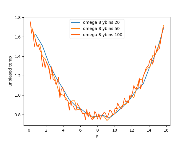

Thank you for your advice. I have employed the PUT strategy using the following commands:
fix 		    1 all deform 1 xy wiggle $(v_A) $(v_T) remap v units box
compute         unbiased_temp all temp/profile 1 0 0 y $(v_ybins) out bin
fix             2 all nvt temp 1.0 1.0 $(100*dt)
fix_modify      2 temp unbiased_temp
Meanwhile, I utilize another compute temp/profile to monitor the temperature distribution after removing the flow field velocity:
compute         monitor_unbiased_temp all temp/profile 1 0 0 y $(v_ybins) out bin
fix             output_temp all ave/time 100 10 1000 c_monitor_unbiased_temp[*] mode vector file unbiased_temp_$(v_omega)_$(v_ybins).txt
By adjusting the variable ybins to divide the bin number in the y direction of temp/profile, I found that the obtained velocity distribution still deviates from 1.0.
puttemp

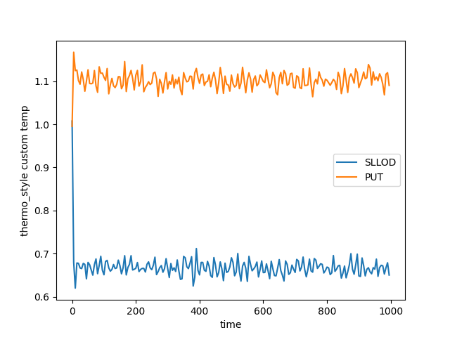

Interestingly, using thermo_style custom temp, I obtained a temperature close to 1.1, whereas previously, when using the SLLOD equation, this command calculated a temperature of around 0.65.
putsllod

I think it may be that the frequency of the applied oscillations is so high that thermostat is not possible, perhaps doing similar sinusoidal oscillations needs to be done within a certain frequency.
Yes – there is always a chance that you are hitting a genuine limit of the thermostat and it cannot dissipate the heat of shearing fast enough.
You can try to make the thermostat more “aggressive”, firstly by setting tchain 1 (chain Nose Hoover thermostats are known to induce inaccuracies for strongly dissipative non-equilibrium simulations ), and then by setting a shorter time constant.
Thanks. So this seems to be an “empirical” problem in LAMMPS, since it seems impossible to determine exactly what value of the oscillation frequency is less than which the simulation results are reliable.
