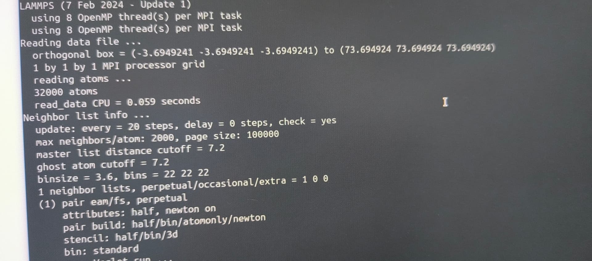

I would like to ask for some clarification regarding the performance of my current LAMMPS setup. I am using LAMMPS 2024, as shown in the attached screenshots.
Could you please let me know if the configuration appears correct and whether the performance is expected for this version?

Unlike many other MD softwares, in LAMMPS different force fields, integrators, etc. are vastly different in terms of performance or GPU support (because LAMMPS contains so many features and they are contributed by many different people). So it’s basically impossible to tell how much performance gain you can get without the full input deck. I recommend read the [accelerate performance] part of the documentation and understand how acceleration packages in LAMMPS work.
With that saying, judging from your limited system size (only 32000 atoms) I would say that GPU acceleration is likely not very useful. I think your best bet is to see if /intel works for you (again it depends on the whole simulation setup). Read the documentation for things to take care when running with the intel package.

Screen shots are a bad idea.
Neither can be inferred from the information available in the image.
