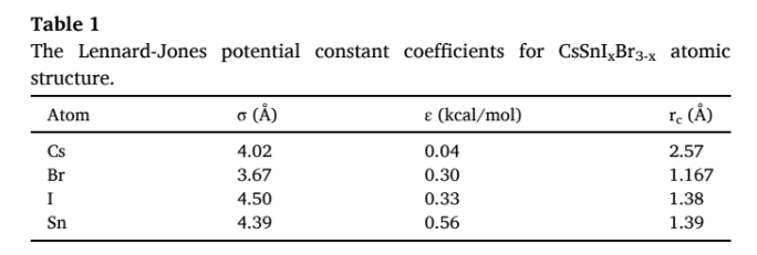

I converted potential parameters as follows:
pair_style lj/cut 2.5
pair_coeff 1 1 0.0242 4.39 1.39
pair_coeff 2 2 0.0143 4.50 1.38
pair_coeff 3 3 0.0017 4.02 2.57
and it is the table of that reference:
Screenshot from 2023-03-26 10-33-40
And again the temperature decreased to 0 K instantly.
When I setting a shortet time step, the temperature increases.
Is this a standard, unmodified Lennard-Jones potential? Does r_c represent the cutoff as is implied by your pair_coeff statements?
It makes no sense to have a cutoff much shorter than the Lennard-Jones \sigma parameter as that would result in a potential that is either zero or highly repulsive, which is causing the behavior that you see.
