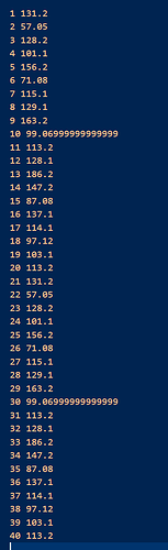

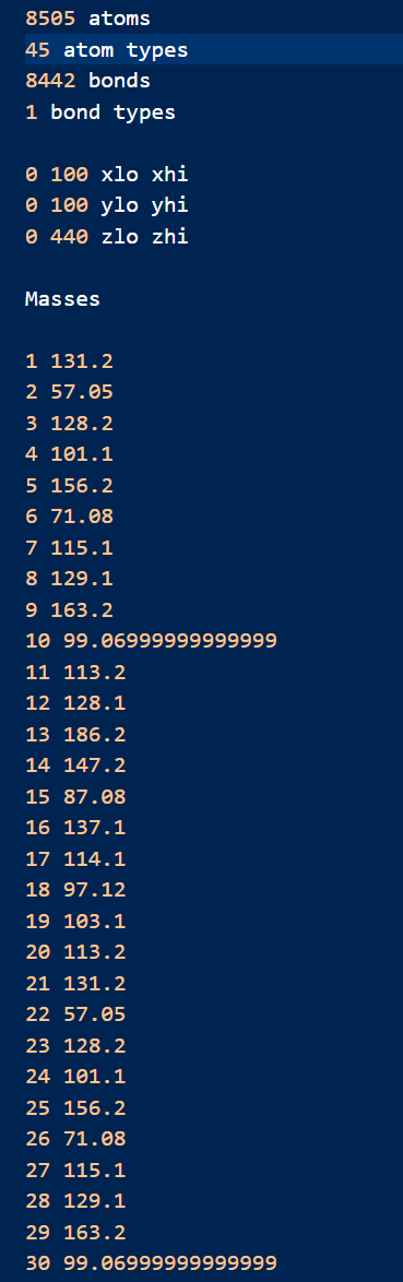

LAMMPS data file via write_data, version 4 May 2022, timestep = 4504000
8505 atoms
45 atom types
8442 bonds
1 bond types
0 100 xlo xhi
0 100 ylo yhi
0 440 zlo zhi
Masses
1 131.2
2 57.05
3 128.2
4 101.1
5 156.2
6 71.08
7 115.1
8 129.1
9 163.2
10 99.06999999999999
11 113.2
12 128.1
13 186.2
14 147.2
15 87.08
16 137.1
17 114.1
18 97.12
19 103.1
20 113.2
21 131.2
22 57.05
23 128.2
24 101.1
25 156.2
26 71.08
27 115.1
28 129.1
29 163.2
30 99.06999999999999
31 113.2
32 128.1
33 186.2
34 147.2
35 87.08
36 137.1
37 114.1
38 97.12
39 103.1
40 113.2

These codes are part of my sturcture.data file. And I found if I delete the Masses part of the structure file, the read_data command works well
This data file is broken and should not work. Its header says there are 45 atom types, but the Masses section has only 40 entries. That is wrong. That also means, that you are giving us incorrect information and the two data files you are using on the two different machines cannot be the same.
No surprise.
Thank you,akohlmey. I has solved that problem. It is truly because of what you said.
