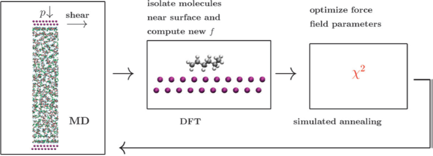

I meet a problem in which the evaluation requires three separated packages. The first package, as shown in following image, is a Molecular Dynamics (MD) program. The second one is a Quantum Dynamics (DFT) program, and the last one is a Matlab/c++/Fortran program.
I would like to run a MD simulation followed by a DFT calculation. Then a comparison between MD and DFT results will be carried out using a Matlab/c++/Fortran program. This procedure, as shown in following image, is repeated until a certain criteria is satisfied.
I mean that: when the MD simulation finishes, it will automatically call the DFT task. Then when the DFT task finishes, the Matlab/c++/Fortran program will be called. Finally, when the Matlab/c++/Fortran program finishes, the MD simulation will be carried out again.
Is it possible to do this ?

Yes, it can be done in various ways. I suggest you
read Sections 6.10, 6,19, and Section Python 11
of the LAMMPS manual, for various ways LAMMPS
can be used in a larger workflow.
