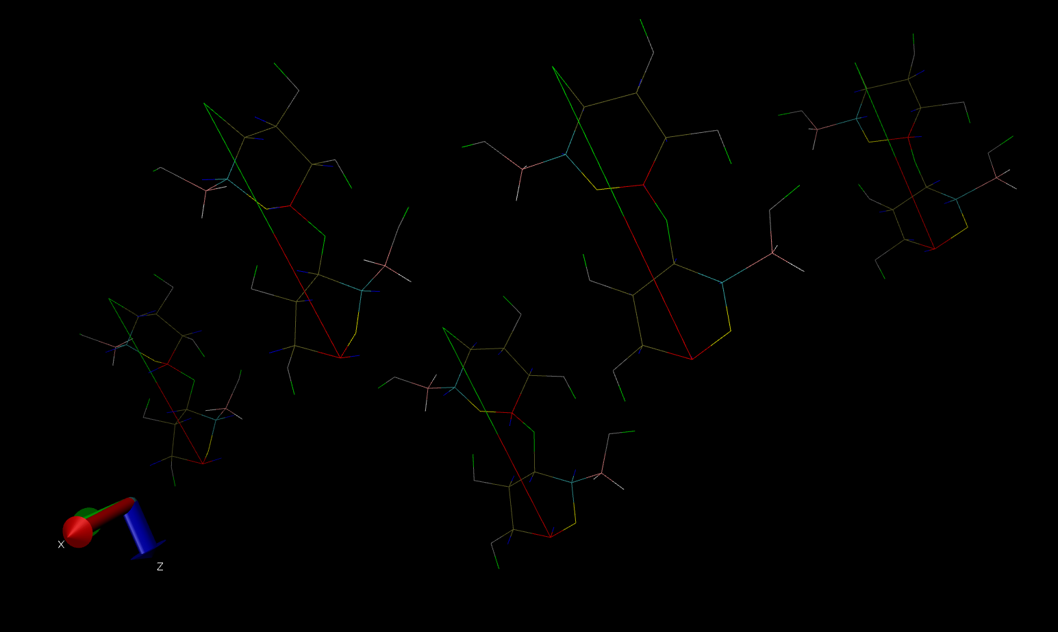

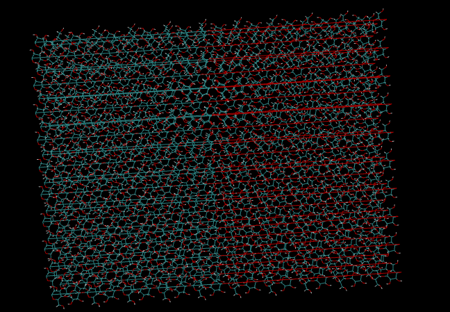

However, when I use these files, an extra bond appears within the cellulose structure, which is clearly incorrect.
Could someone kindly share the correct or working versions of top-all36-carb.rtp and top-all36-carb.prm that were used successfully for this cellulose system? Or advise on how to modify the existing ones to avoid the incorrect bond generation?

I am not so sure about that. You have a periodic system and the long bond like this would show up in VMD this way for bonds reaching across periodic boundaries. It appears, however, that your box dimensions are not proper for that and there are significant gaps between periodic images.
I don’t think those are the problem here.
Those are for certain not the original files. The canonical location for obtaining the official CHARMM force field parameters is on Alex Mackerell’s homepage.

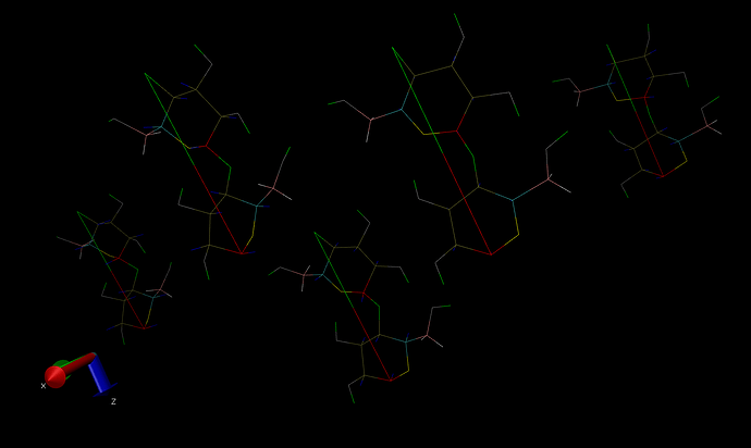

this is the output when iam using updated version of .prm and .rtf files
When i used the files from here Charmm36_FF/toppar at master · ChayaSt/Charmm36_FF · GitHub
conversion worked but as mentioned previously there is an line passing across the cellulose
