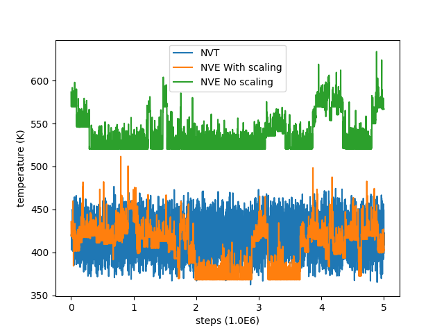

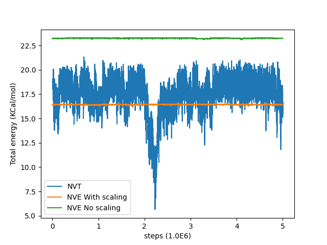

However, I notice that in the new NVE simulation the temperature suddenly jumped to 520 K and the total energy jumped to 23 KCal/mol. Why is this sudden jump happening? I again ran another NVE simulation in which I scaled the velocities using
velocity all scale 420
and in this case the temperature and total energies were more close to the average values in the previous NVT simulation. I’m attaching with this two plots showing the fluctuations in temperature and energy for the NVT simulation, the NVE simulation without velocity scaling and with velocity scaling.
temp
energy_total
As we can see the temperature in the NVT simulation never goes above 470K and the total energy never goes above 21 KCal/mol, so this issue could not have been caused by the restart file being at a higher temperature point during the writing. Also the final value of temperature and total energy in the NVT simulation is 400K and 15.5 KCal/mol respectively.
Then why is this sudden rise happening?

Are your output graphs based on the thermo output of your scripts, or the fix ave/time output?
I’m plotting the fix ave/time data here. Thank you.

Hi, here are the input files for re-creating the simulation. I’m actually using this 16 atom setup as an example to learn LAMMPS. I understand that temperature fluctuations are normal and expected for such a small system. But here I observe a sudden jump from 420 to 520 immediately after reading the old velocities from the restart file, this made me suspicious that there is something wrong with the reading of velocities from the restart file.

Then the discrepancy is very straightforward, to me:
You have a very small system (16 atoms!! Even Rahman’s 1960s papers had more atoms than that!!) in gas phase that you have thermostatted with Nose-Hoover (so you are artificially correlating all the atoms’ velocity).
Thus it is very possible for the total energy to fluctuate significantly step by step under NVT integration.
fix ave/time in your script is taking an average over 50 snapshots spaced 20 steps apart (or vice versa, I don’t remember). There is no guarantee that that average is the same as the instantaneous energy of the single configuration recorded in the restart file.
You just happened to record a restart when the instantaneous energy was quite different from the 1000-step / 50-snapshot average.
On the other hand, thermo output records the instantaneous values of the recorded variables. So if the thermo output had discrepancy between writing the restart and loading from the restart, that would genuinely be grounds for concern.
