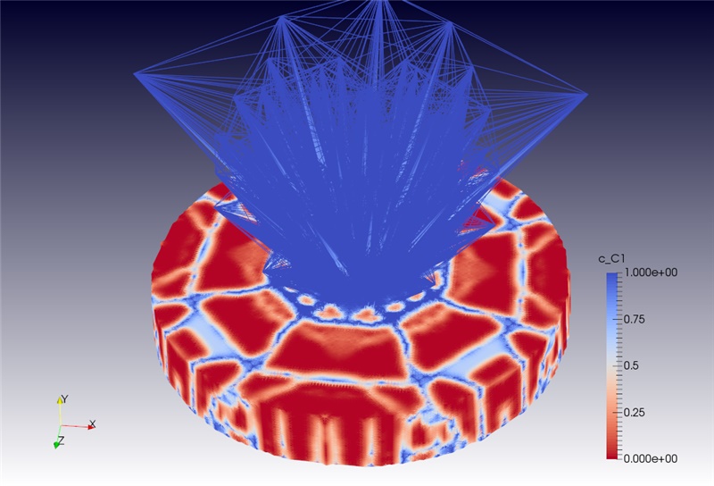

increase. I visualized the damage computed by the lammps Peridynamic

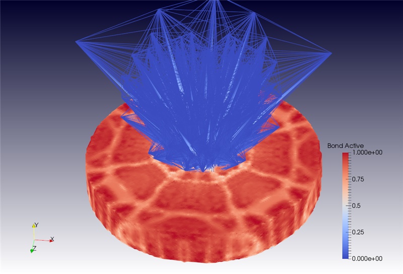

package in picture1.png and reconstruct his value from the computed
bonds with the described command picture2.png. The result differs and my
question is how to access the neighbor information for an atom/particle?
Why does this list differ from the computed damage?

The damage inside the PD module the the ratio of broken bonds to initial bonds. This scalar value is visualized in the first image.
In the second I reconstructed this information of the dumped file with the bonds to verify if I got the correct neighbor information. Ok, this explains the difference of the two images.
Is it possible to produce this information with lammps? A history of the bonds between PD particles excluding the close atoms without a bond?

In picture 1 i visualize the scalar value of the compute all damage/atom and this is equation (3.10) in the following document
. Now I use the bonds in the second dump file to reconstruct this values, because I need the bonds for some post-processing of the simulation. But this pictures do not look identical. MY question is how to get the same bond information as used in the computation of the damage. Regards Patrick
