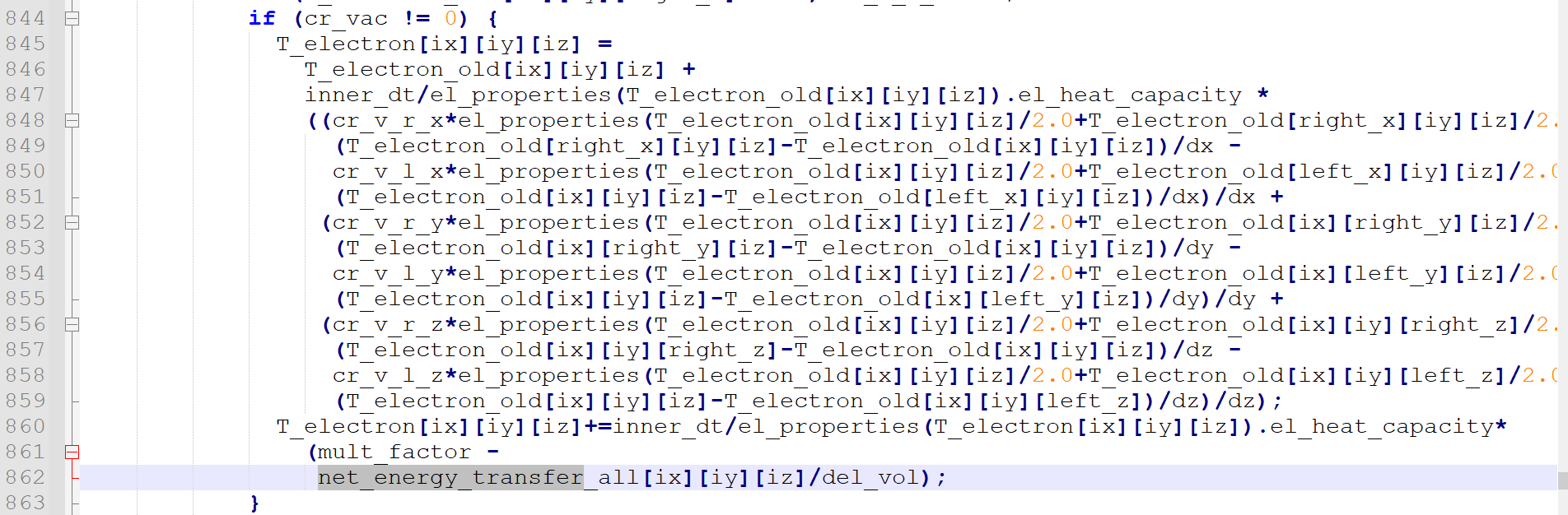

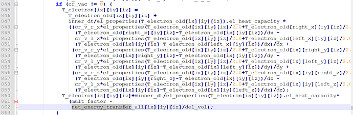

From source codd fix_ttm_mod.cpp, we can see that the temperature of each electron grid is computed from the 1. heat conduction from nearby grid cells.(line 844-859) 2. input energy(laer)(line861 mult_factor) 3. energy transferd from atoms(lin862, net energy transfer)

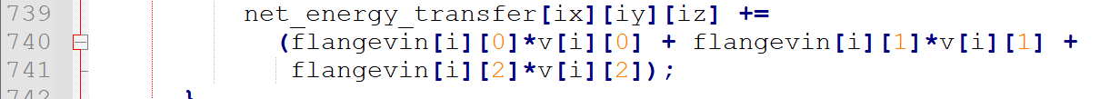

I am trying to get the atoms at each grid cells’ temperture to modify source code so I turned to the calculation of net_energy_transfer_all
this is the most relevent information about net energy transfer all
Q1: I don’t understand how the net_energy_transfer_all is calculated, maybe it is calculated in another file?

However, I do find some related codes to deeped my understanding about this command.

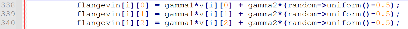

the energy transfer between electron and atoms are done through langevin force so I find the langevin force calculation term:
the force acting on each atom are calculated by factors gp and gs.
then using calculated per-atom force to determine energy.

It is computed here by summing the contents of the net_energy_transfer grid across all MPI processes with MPI_Allreduce(): lammps/src/EXTRA-FIX/fix_ttm_mod.cpp at a4a206e601d114e612945dcf7361cb2105ac81b5 · lammps/lammps · GitHub
No. I suggest you google for “grep is your friend” to see how this can be easily checked for in a big software package with many files.
Why not check the documentation? Start here: 3.9. Fix styles — LAMMPS documentation
Also looking at the source code of the corresponding base clase is often helpful: lammps/src/fix.h at a4a206e601d114e612945dcf7361cb2105ac81b5 · lammps/lammps · GitHub
The Fix::compute_*() functions are how computes, variables, other fixes and so on can access some internal data, e.g. via f_fixid[2]. See, e.g. 8.3.1. Output from LAMMPS (thermo, dumps, computes, fixes, variables) — LAMMPS documentation

I understand per-atom temperature is meaningless and per-atom velocity is important. What I meat is that: as the equation in the first picture illustrates, the magnitude of transport energy between two system is determined by the temperatue difference and g_p,where is the per-grid temperature T_a? From your reply and the source code, do you mean calculating grid temperature of atom is tricky so that you used per-atom velocity multipy force(as force is a vector) to represent energy transfer? Am I correct?
