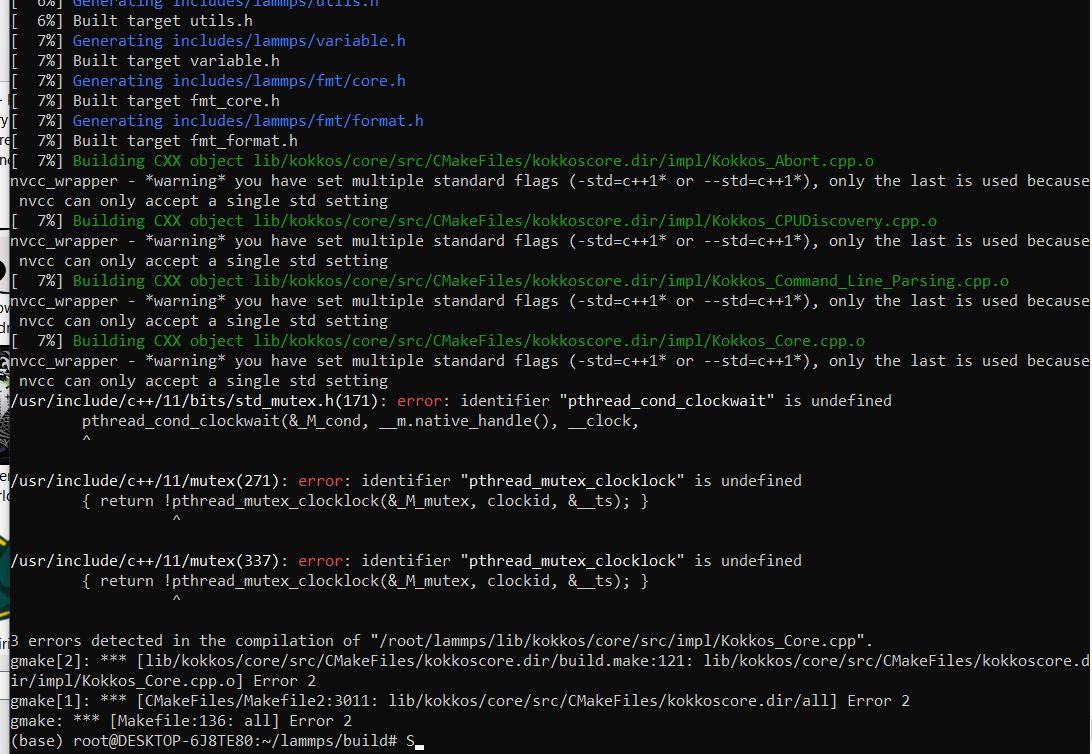

Keep getting this error "error: identifier "pthread_cond_clockwait" is undefined"
I cannot fix this error at all. Trying to compile lammps with the given kokkos presets in the cmake folder. Always run into this error. Any one have any ideas how to fix this?
[ 7%] Building CXX object lib/kokkos/core/src/CMakeFiles/kokkoscore.dir/impl/Kokkos_Core.cpp.o
nvcc_wrapper - warning you have set multiple standard flags (-std=c++1* or --std=c++1*), only the last is used because nvcc can only accept a single std setting
d
pthread_cond_clockwait(&_M_cond, __m.native_handle(), __clock,
/usr/include/c++/11/mutex(271): error: identifier “pthread_mutex_clocklock” is undefined
{ return !pthread_mutex_clocklock(&_M_mutex, clockid, &__ts); }
/usr/include/c++/11/mutex(337): error: identifier “pthread_mutex_clocklock” is undefined

Thanks for the reply. Answer to your questions:
  1. Lammps version: latest, just today cloned from repository
  2. OS: Ubuntu, Ubuntu 22.04.3 LTS
  3. Compiler: Tried with g++ 11 and g++ 13. the problem persists in both
  4. CUDA toolkit 12.9
  5. Commands ran after cloning git, to actual compilation (Just like in lammps doc. website):
    mkdir build-kokkos-cuda
    cd build-kokkos-cuda
    cmake -C …/cmake/presets/basic.cmake
    -C …/cmake/presets/kokkos-cuda.cmake …/cmake
    cmake --build .
  6. No i have not set any enviroment variables.
Chatgpt says “pthread_mutex_clocklock” error occurs if GLIBC version is less than 2.30, but my version is 2.35.
I can compile the normal PKG_GPU normally. For the kokkos package i run into this error.
