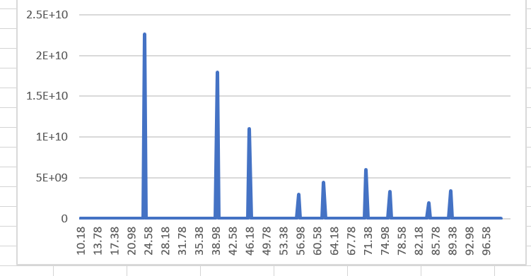

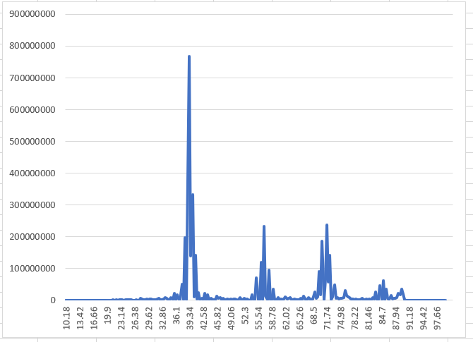

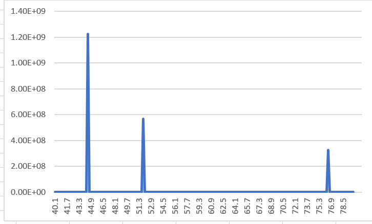

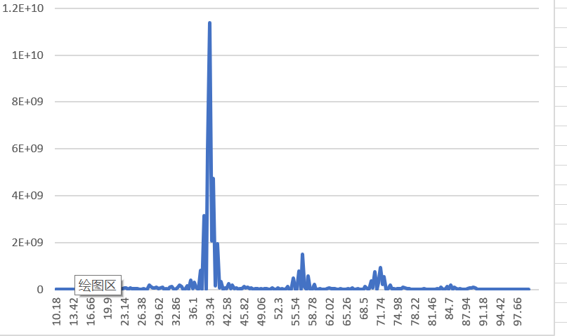

In the case of a perfect CdTe single crystal, I tried a lot of output files in parametric cases, and none of the XRD plots were output in a single crystal style.
L=0
1725270132(1)
L=1
L=1 no manual c=1 1 1
I also tried the file given by Lammps’ official website, and he is also a perfect single crystal, and the output XRD is still not a single peak.
I would like to ask you how to get XRD images of single crystals.
Thanks!
Why should there be only one peak?
According to the relevant knowledge of X-ray diffraction that I have learned before, only the crystal surface parallel to the surface of the sample can participate in diffraction. If the diffraction peak becomes wider or there are more other small peaks due to experiments and other reasons, it is okay, but my three crystal directions are 001, 010, 100. In theory, the strongest peak should be the 100 crystal surface family, but the strongest peak I analyzed appears on the 111 crystal surface.
