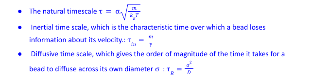

I am trying to simulate a bead-spring polymer system with LJ 12-6 or WCA type interaction. There are three important timescale in the system:
Following previous published study on similar systems, I chose: m=\gamma=k_BT=1 which implied \tau=\tau_{in}=\tau_B.

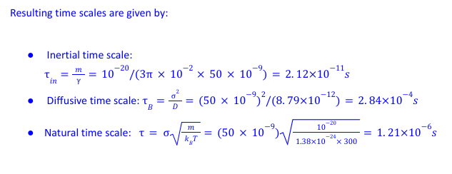

In my system, m=10^{-20} kg, \nu=10^{-2} P, \sigma =50 nm~~ \text{and}~~ T=300K.
Clearly this shows the three time-scales are orders of magnitude different and \tau_{in}<<\tau<<\tau_B. Now For numerical stability one must choose the time step \Delta t smaller than all of these times i.e. \Delta t<\tau_{in}<<\tau<<\tau_B. However, I wish to study phenomena which will occur on times of the order diffusive timescales \tau_B. To avoid unfeasible long run times I keep \Delta t =0.005\tau_B \sim 10^{-6}s which ensures many steps occur within a typical diffusive time.

I am not sure what you mean by those chained equalities; as your own calculation shows, these timescales are vastly different.
Which means that the answers to your questions are fairly straightforward and standard: since the inertial timescale is much, much shorter than the thermal and diffusive timescales, your system does not “remember” any inertial motion on the timescale over which it actually shows any meaningful thermal or diffusive movement; this does correspond to the “overdamped regime”, which in practice means that there will be negligible difference between Boltzmann dynamics and Langevin dynamics.
