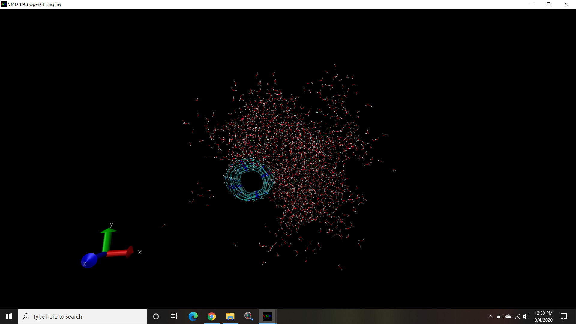

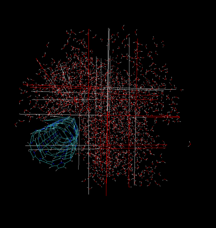

  4. When i tried opening the lammps trajectory i get the structure as it appear in the attached file
  1. When I tried opening the xtc file using vmd as we do for gromacs trajectory, I get these long bonds, which might be related to pbc. How to rectify it.

  1. When i tried opening the lammps trajectory i get the structure as it appear in the attached file
there is no question here.
this is a VMD/visualization issue. apparently you have stored “wrapped” coordinates so if atoms belonging to a bond move across periodic box boundaries, you get this kind of image.
