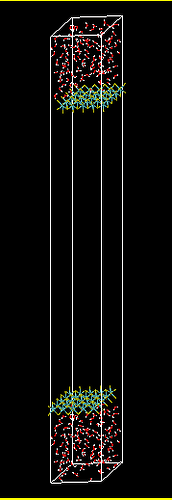

I suspect there is something wrong with the input data file but I am not able to pinpoint the problem. From visual inspection, it seems fine as shown in OVITO below. I also revised the units, bond/angle types/definitions in the input file. I have attached the input file, data file, and error log to this message.
