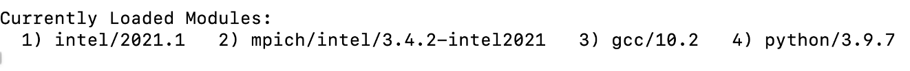

My module loaded packages on the HPC cluster:

You have to look very carefully at the output that you get during compilation.
The plumed configure script should find your MPI library automatically. It does for me:

So you have to make certain that your environment module for MPI is always loaded and that you load the same module when you do “make lib-plumed args=-b” and when you do “make mpi”.
The alternative would be to try compiling with CMake. That should give you more feedback but be functionally effectively the same. It just compiles everything in one step.
