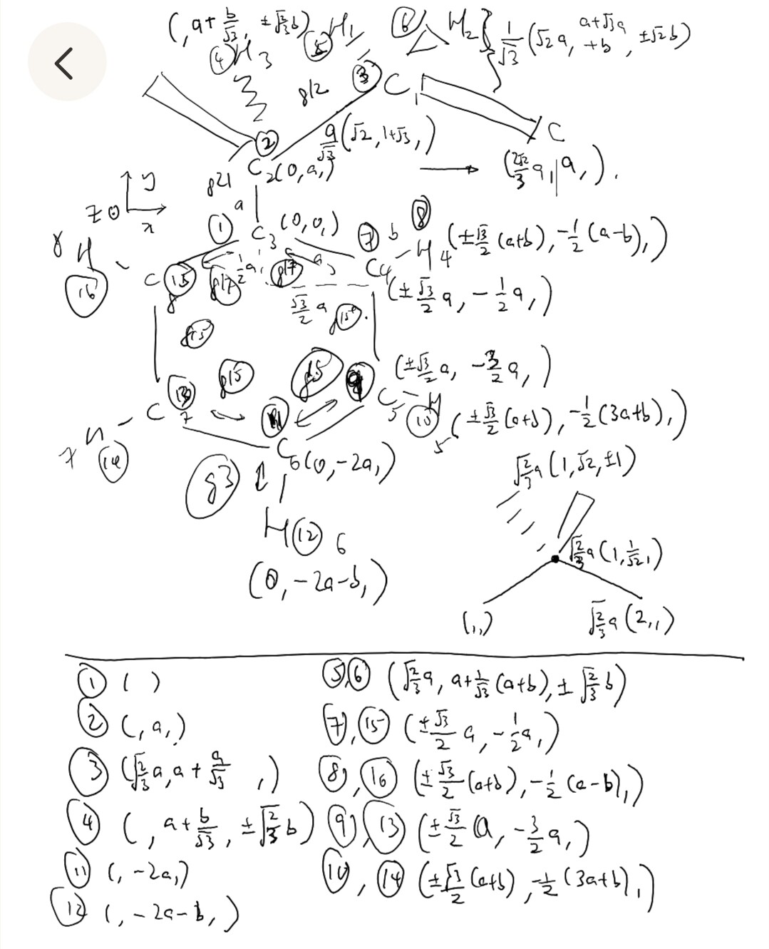

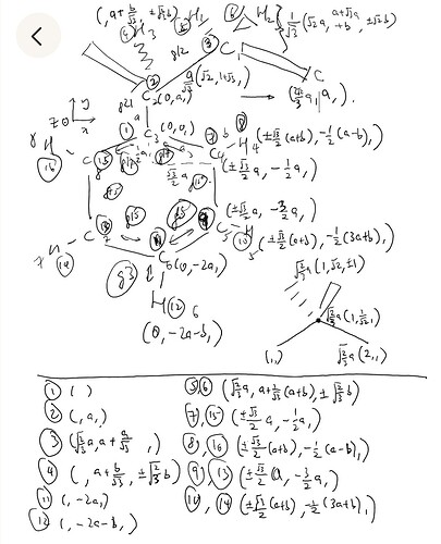

Yeesh – that’s certainly a lot harder.
This feels like a job for moltemplate some day.
