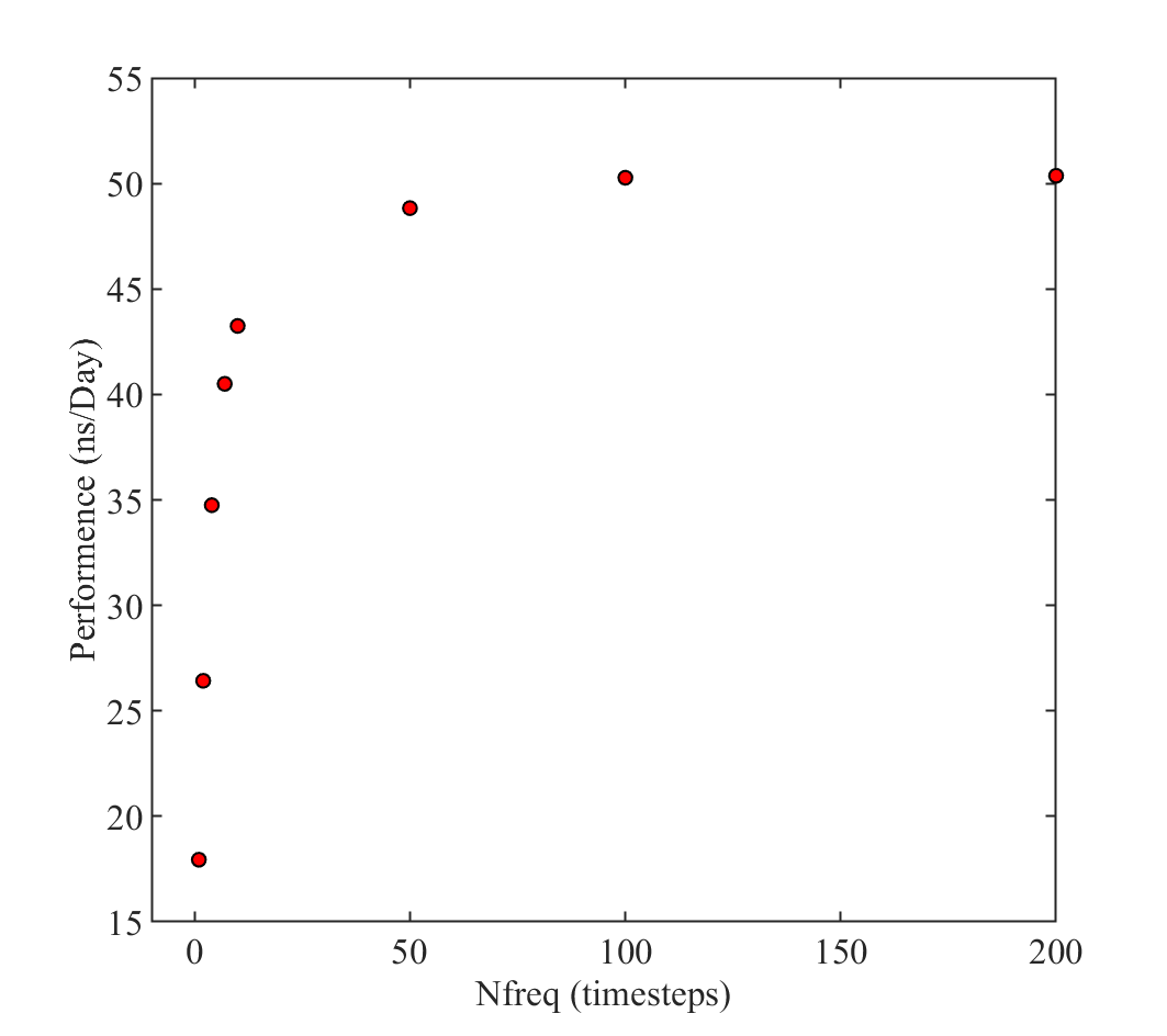

After the equilibration run, I’m just calculating the heat flux via “compute heat/flux” and taking it out via “fix ave/time”. When I change the Nfreq of the time averaging fix, the simulation performance changes significantly as follows.
time averaging fix: “fix AVE all ave/time 1 1 Nfreq c_Hflux[1] c_Hflux[2] c_Hflux[3] ave one file Hflux_AVE.out”

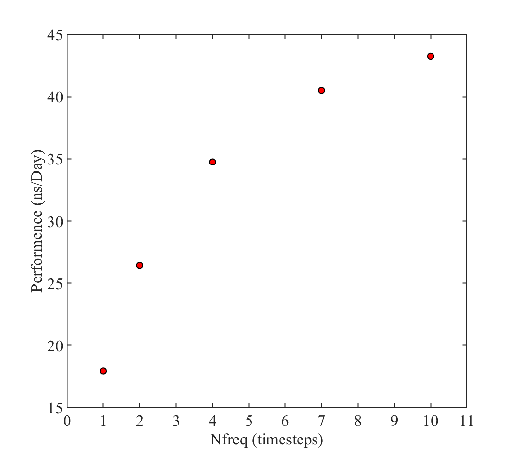

It seems like, when the Nfreq is reduced beyond 50, the pair calculation time and modify time (from the MPI task time break down summary in the log) increases significantly affecting the overall performance. However, after around Nfreq=100, the performance converges as follows.
It is clear that when Nfreq is changed from 1 to 10, the performance gain is more than 2 times. Is this normal or am I doing something wrong? Your kind advice is really appreciated. I have attached the relevant log files as well for the cases of Nfreq=1,2,4,7, and 10.

Ok, now here is why there was a misunderstanding.
You wrote that you “increased the frequency” of collecting heat/flux data, but in fact by increasing the value of “nfreq” you are decreasing the frequency.
That in turn makes perfect sense. For computing the heat/flux data you also need to compute the per-atom stress data. This is normally not done during the force computation for efficiency reasons and if needed only on those timesteps where this data is accessed. So by sampling the per-atom stress less frequently, you are speeding up the computation in the pair style by having to compute and collect the per-atom stress data less frequently. Of course, the savings will decrease if you raise the value of nfreq further.
As mentioned before, the main cost is for computing the forces (and the stress from them) and not compute heat/flux in itself, even if it may seem to you like it, because the compute is only post-processing data accumulated during the force computation.
Oh, that’s my bad. I went upside down on the term “frequency”. Thank you very much for your detailed explanation.
