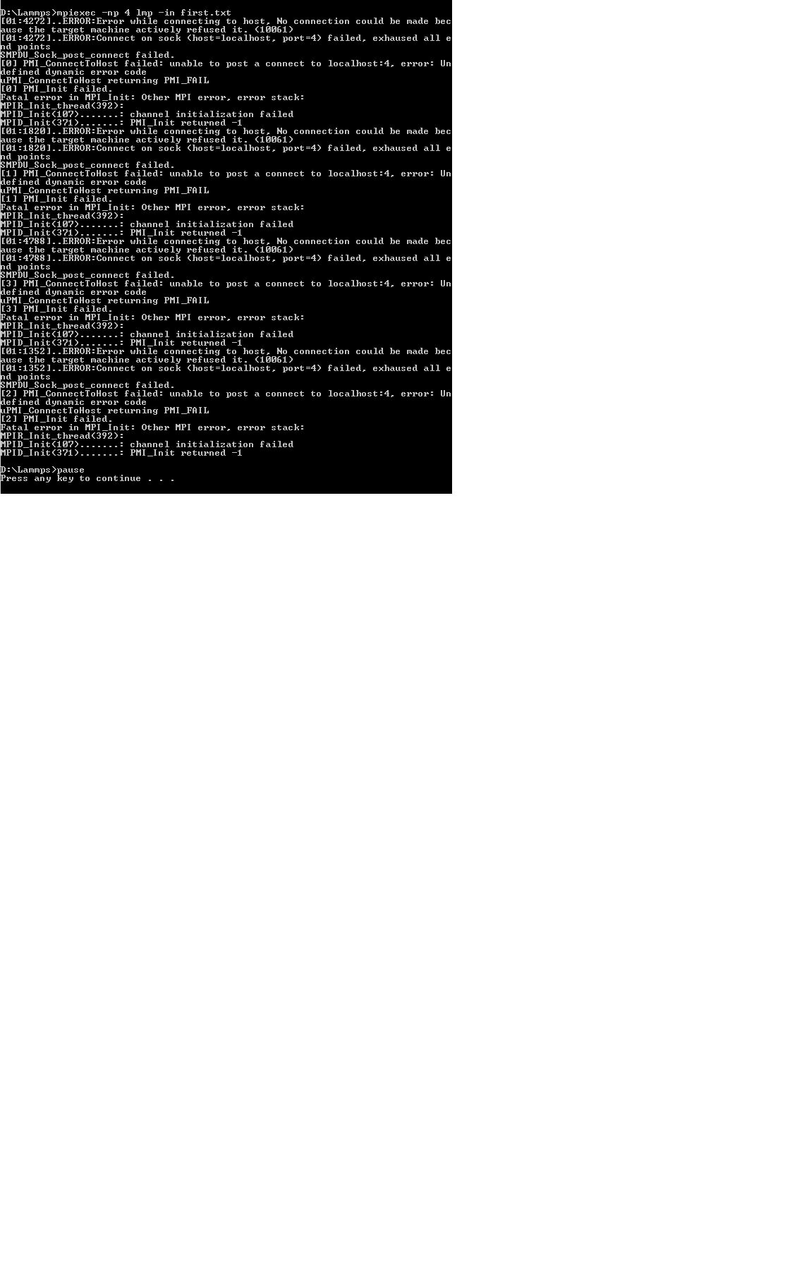

when I run my program with command: mpiexec -np 4 lmp -in first.txt
I get the following error (also the image of error is attached ) :
Error: error while connecting to host, no connection could be made because the target machine actively refused it.(10061)
how can solve this problem?

Did you register the smpd service in administrator mode?
Have you tried using “-localonly” instead of “-np”?
Here is the corresponding text from the online docs:
After the installation of the MPICH software, it needs to be integrated into the system. For this you need to start a Command Prompt in Administrator Mode (right click on the icon and select it). Change into the MPICH2 installation directory, then into the subdirectory bin and execute smpd.exe -install.
MPI parallel executables have to be launched with mpiexec -localonly # lmp ... or mpiexec -np # lmp ... with “#” being then number of parallel processes to start. For the latter you may be asked for your password.

I had done all the mentioned points, but there is still the same error.
How can I solve this?
