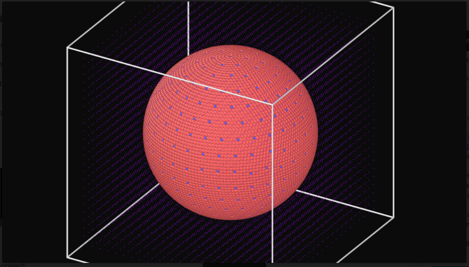

I have been working on developing a code for a Simple Eukarotic Cell within Lammps.
This paper ( Lennard-Jones type pair-potential method for coarse-grained lipid bilayer membrane simulations in LAMMPS - ScienceDirect) has been a major help but I am at somewhat of an impasse now.
When I run my simulation, it goes fine until i try to read the data file, once this happens I get the error message "Segmentation Fault (Core Dumped) " and the sim cancels out.
I have done some digging on this message and I haven’t seen anything directly on it, just some old posts that didn’t help too much.
Included are the input file I am trying to run, the first few lines of the data file, and a picture of the data file ( as the full file is wayyy to long)

Data File
#RBC_V2.data
21702 atoms
3202 bonds
8346 ellipsoids
7 atom types
3 bond types
-35 35 xlo xhi
-35 35 ylo yhi
-35 35 zlo zhi

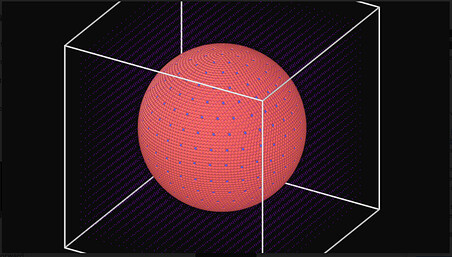

Picture of Data
Thanks so much for any help you can provide,
