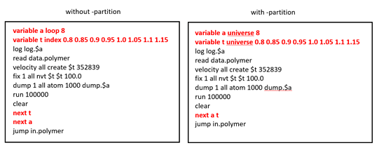

In the Lammps manual (https://lammps.sandia.gov/doc/Howto_multiple.html) , the last example says:
"if LAMMPS were run on 3 partitions, the same scripts could be used if the“ index ”and“ loop ”variables were replaced with universe-style variables, as described in the variable command. Also, the“ next t ”and“ next a ”commands would need to be replaced with a single“ next a t ”command. With these modifications, the 8 simulations of each script would run on the 3 partitions one after the other until all were finished. Initially, 3 simulations would be started simultaneously , one on each partition. When one finished, that partition would then start the fourth simulation, and so forth, until all 8 were completed. "
From those comments, I made the modifications below. Could someone tell me if they are correct?
Going back to my example (16 simulations with 6 processors each), with the command -p (-partition) I should change my .pbs file as follows:
#PBS -q queue96
#PBS -l nodes = 8: ppn = 12
mpirun -p 16x6 lmp_intelmpi < lammps.inp
Or am I mistaken? Sorry but I don’t understand the -partition command very well.
Any suggestions are welcome, as I don’t know anything about parallel computing.
