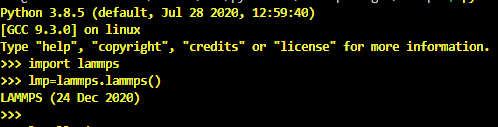

I firstly installed the shared mode LAMMPS using the command “make mode=share mpi” in the src dictionary, then input the command “make install-python”.
I tested like that,
I think there must be something wrong. Could you help me figure it out?

Thanks for your response. I have changed my LAMMPS version to December 2020, and my platform is “Linux DESKTOP-PECIRI9 4.4.0-19041-Microsoft #488-Microsoft Mon Sep 01 13:43:00 PST 2020 x86_64 x86_64 x86_64 GNU/Linux”.
I read the content in your attached link in detail. But please understand that I am not a good Linux user that there is still something unclear to me.
if you have technical difficulties or problems of understanding with the Linux platform, you should find somebody local that has the necessary experience and can help you and address your concerns.
I tested like that,
there is nothing wrong visible here. this looks like both, compilation and installation, did work as expected.

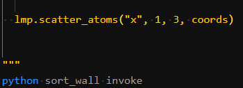

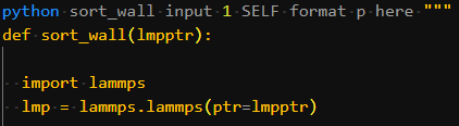

When I perform the simulation using a script including a python function, it would report errors. My head and end of python part in the LAMMPSscript are like that respectively,
The terminal window report the error “ERROR: LAMMPS is not built with Python embedded (…/variable.cpp:797)
Last command: python sort_wall input 1 SELF format p here “””
It is really confusing.
this is all explained. you are mixing up the python “module” with the python “package”.
when you want to include the python package you:
- first install the python package into the LAMMPS source code for compilation (e.g. via make yes-python for the conventional make based installation)
- then compile LAMMPS for the desired machine settings (e.g. make mode=shared mpi)
- then install the LAMMPS “module” and shared library into the location where python can find it (via make install-python)
quite straightforward, if you think it through. if you don’t do the first step first, your compilation in the second step is missing the feature and that is why the python command won’t work in a LAMMPS input, but the import of LAMMPS as such into a generic python interpreter works (since that is done with the third step).
