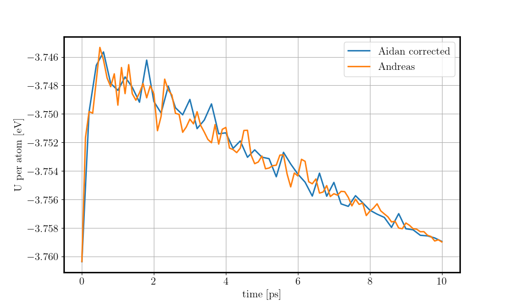

Now it is seems to be correct:
Also the relaxation seems to be fine:
