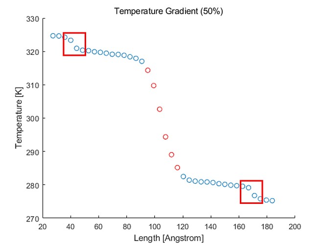

The below picture is my temperature profile of semi-crystalline polyethylene with two Langevin thermostat applied. Temperature of heat sink/source is fixed to 325, 275K.
I wonder why there is a temperature drop right after(before) the heat sink(source).

Well, a temperature drop generally appears as the solution to the Fourier heat equation across a gap in heat transmissibility. It could of course also be an error in your simulation setup.
We cannot tell even which of these it is (or both!) without further information. In particular, if you think this gap shouldn’t be there, what have you tried in order to remove it, and what have the results been?
How does it make sense to apply two thermostat to the all group consecutively?
How are Thot and Tcold computed?
This looks like a bogus setup to me…
I don’t think that temperature gap shouldn’t be there because typical NEMD temperature profile seems like the that.
But, I wonder why that temperature drop happens during NEMD simulation.
