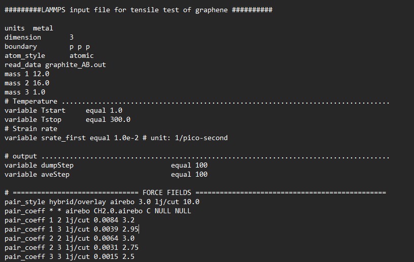

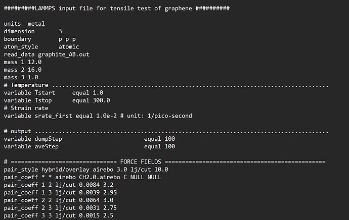

I’m currently working on my final project which is working on functionalized graphene with OH.
My question is regarding the force field I have used Airebo to define the interaction between the C-C.For others interactions, I used LJ potential the results I got when I run the simulation ( OVITO ) doesn’t make sense and It shows instant break before running the test.do I have to mention other parameters or Sigma and epsilon of the interactions should be sufficient to allow me observe the interaction between the graphene and the OH
Looking forward for clarification.
Where did you find the parameter for the C-O-H interactions?
Your parameters make very little sense, it seems like a force field that you are inventing.
Simulations strictly follow the GI-GO principle (= garbage in, garbage out).
Do you have any evidence that you can model graphene functionalized with OH groups by only using LJ interactions? I would be very surprised if that would work.
Traditional molecular force fields also need bonds and angles and partial charges assigned to those atoms. Which also means that you cannot run with atom style atomic.
You will need to do some more research into what would be a suitable force field and what set of parameters for that specific force field would be suitable for your material and the conditions that you are simulating. Please keep in mind that for classical models, it is not sufficient to only mention the elements (unlike in quantum chemistry), but force fields and parameter sets are quite specific and may need to be different for different compounds and conditions. I would perhaps do some research if there is a suitable ReaxFF parameter set that was testing successfully on functionalized graphene. This seems to be a popular enough topic so that some publications should exists, if it has been done and worked out.
A few more comments:
  • using pair style hybrid/overlay makes no sense. just hybrid should suffice for a mixed force field setup and doesn’t have the risk of double counting.
  • you seem to have a modified AIREBO potential file. with things like that all bets are off anyway.
