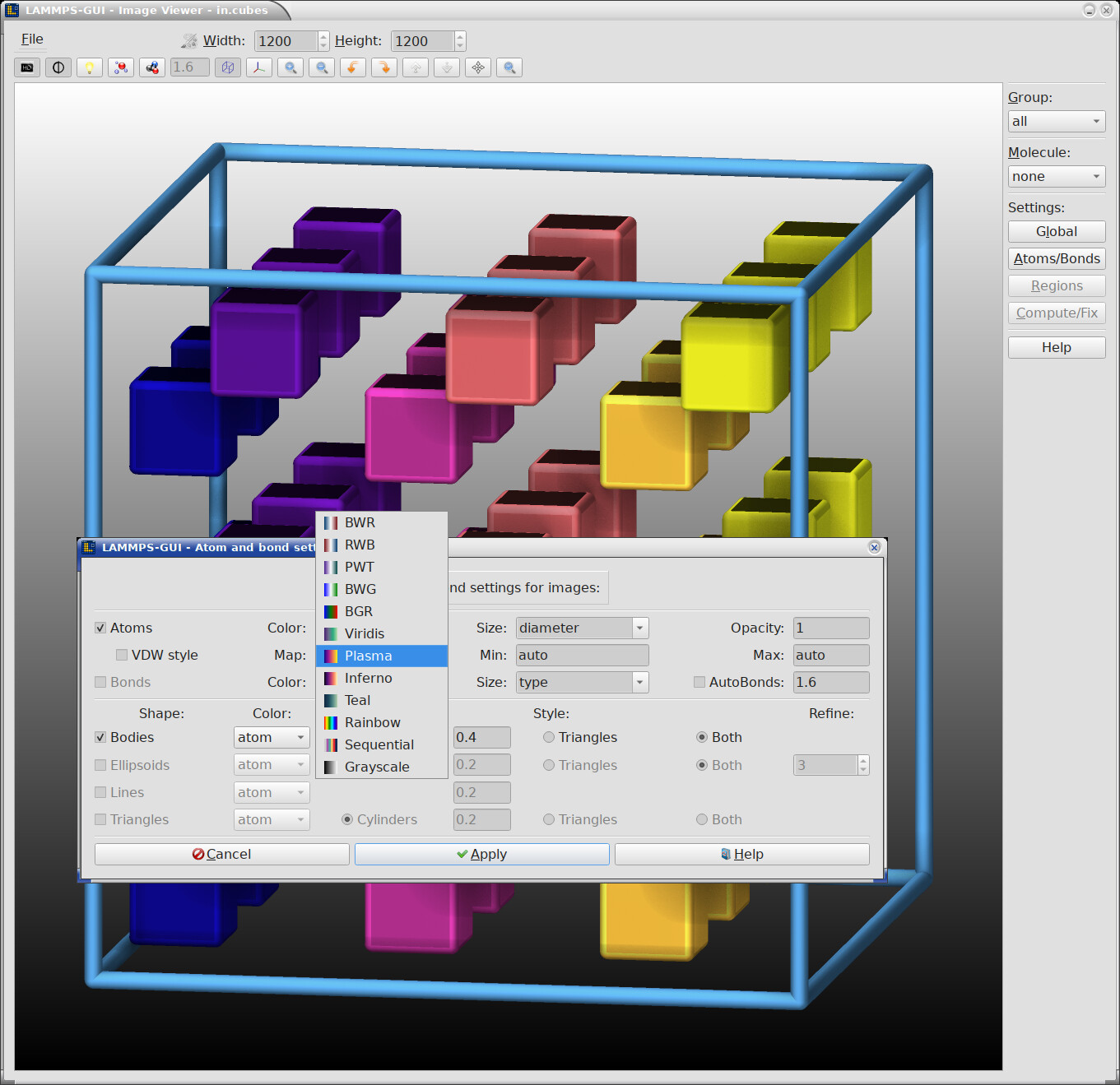

Highlights since the last full release (1.9.1) are major updates to Snapshot Image Viewer and Slideshow viewer. Their layout was improved and made more consistent across platforms. When used with a recent LAMMPS version, there are many more settings and features available. Most notable the option to select color-by-property (available properties are listed in a drop-down list) and to manually adjust atom and bond diameters. For color-by-property multiple predefined colormaps are available (see screenshot below).
