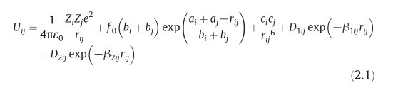

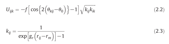

I want to simulate the potential described in this paper (Eqs. 2.1 - 2.3) in LAMMPS.
For the sake of convenience, the equations are:
screenshot-2024.10.12_17.31.42
Eq. 2.1 is a pairwise interaction while the Eq. 2.2 is a three-body term with k_ij (k_ik) given by Eq. 2.3.
