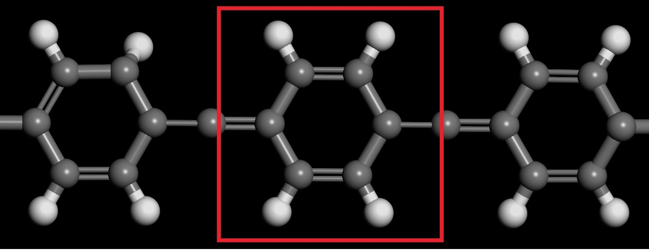

Hi Lammps Users,
I have a structure like this (see photo). I have noticed that the middle ring rotates/flips during the simulation, which is very interesting.
Do you have an idea how I can measure the frequency of its rotation (representing rotation tendency/mobility of the ring)? How can Lammps help me in this respect? We need to measure this property and compare it with other structures, having other functional groups on the middle ring.

I assigned the atoms of the middle ring to a group, and intend to investigate some of their properties using four related chunk commands. Hopefully they will show some indications of the rotation behavriors.
*If you have other ideas, please let us know.
