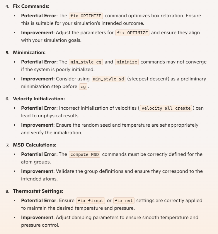

Given that we are now in the age of AI and the potentials that this presents. I took the plunge to ask AI about potential errors and possible corrections in my MSD code for high entropy alloys and the results is as attached.
I am trying to reuse the code for practice and potentially apply it later
Question:
  1. Regarding minimization, how can we test/know that the minimization is giving the required result?
  2. What is the options to the fix OPTIMIZE code, what else (other fixes or lines) can be in lieu of it?
  3. Is it okay to remove the velocity line entirely and replace with thermostat for equilibration
  4. What information can we use the output of the minimization result for? and how does this compare with results from ab-initio calculation with VASP or Quantum Espresso?
There is no fix optimize in LAMMPS. The list of all available fixes can be found here
https://docs.lammps.org/fix.html
Similarly there is fix npt but not fix fixnpt.
It is better to read a standard textbook like Allen & Tildesley or Smit & Frenkel than to rely on AI. You can also find examples for computing diffusion in the lammps distribution (lammps/examples/DIFFUSE at develop · lammps/lammps · GitHub)
HTH, Evangelos

Thank you for your reply. This sure helps. Still need clarification on question 4 -
I was goin to say the OPTIMIZE was just an ID name but it was used with other arguments signifying the intended use was for relaxation.
If you have time help with question 3 and 1.
How do we differentiate minimisation from convergence? are they thesame?
And sure the advise is well heeded as i am being guided by textbooks and humans too. I appreciate the response from the forum

Regarding Q3 if you are using fix nvt or npt in your script as AI suggests then you are using a thermostat. You should make sure that at least there is no net momentum translating the entire simulation box. Thus the option zero linear in velocity command is very useful.

But, to explicitly comment on each of these suggestions:
Point 4 essentially says “ensure that you actually want your box size to change during minimisation”. This is a sensible suggestion but note that the LLM hasn’t actually told you whether you should use fix box/relax.
This is a classic piece of “Barnum advice” where, if I give you an exhaustive list of alternatives and remind you that you need to choose one of them, you will think I have given you valuable advice when in fact I have simply stated a tautology. “To be, or not to be?” sounds profound, but it’s not like there’s a third option available.
Point 5 is not particularly useful – if your system doesn’t converge with the standard conjugate gradient it’s even less likely to converge under steepest descent, which is generally known to converge more poorly and slowly (although maybe I simply haven’t done much minimisation before).
Point 6 is also not useful – velocity create by itself is almost never sufficient for equilibration. “Make sure you set the correct temperature” is almost insultingly trivial. “And choose the correct random seed” is nonsense!
Point 7 is again insultingly trivial. If you did not specify the correct group for computing MSD then what would you have specified correctly?
Point 8 is actively harmful – in a typical molecular dynamics simulation, you will be studying small systems over short time scales whose pressure and temperature will severely fluctuate. Strong damping that “smooths” the pressure and temperature variation would likely distort the equations of motion so much as to invalidate any diffusivity calculations.
