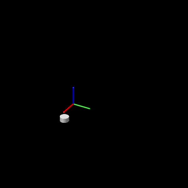

There is not enough information here to understand what you are looking at in OVITO, but using the built in visualizer in LAMMPS in the latest development code, I can visualize that region, too, and it looks like it is moving as expected. Here is my input:
units real
region box block 0 200 0 200 0 200
create_box 2 box
mass * 1.0
variable dx equal "-3*step*dt"
variable dy equal 0
variable dz equal 0
region tool cylinder z 140 50 10 40 50 side in move v_dx v_dy v_dz units box
timestep 0.1
dump viz all image 10 myimage-*.ppm element type size 600 600 zoom 1 shiny 0.6 fsaa no view 60 30 box no 0.025 axes yes 0.2 0.02 region tool white filled center s 0.5 0.5 0.5
dump_modify viz pad 9 boxcolor yellow backcolor black element H H adiam 1 0.6 adiam 2 0.6
run 500
myimage
